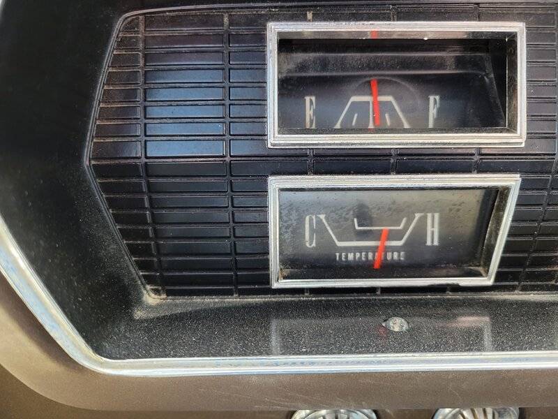

I'm well aware of how thermostats work, thanks - but there's nothing "normal" about an engine designedWell just a little info on how the t-stat works. Some 60's Mopars came factory 195 n some 180. A 195 "starts" to open at 195 and completely open at 210. 180 "starts" at 180 n fully at 195. 210-220 at idle w a/c in extreme heat is normal. When it is in the high 80's here, it idles at 198 for an hour. Here's where the needle is at 219°. No boil over, no puking once turned off etc.. no clattering or dieseling when shut off.View attachment 1130866
