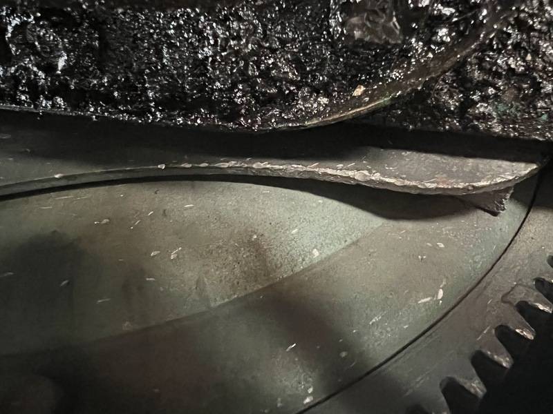

What is this sound?
It's weird that the damage is not contained to a single spot.

Look straight up there and have someone turn the motor. Somethings hitting
I think the drain plug on the converter may have started the problem.
I think it hit somewhere and caused an interference spot.
I don't think it's the correct style plug.
Only thing up there would be an oil gallery plug coming out or the cam pushed the back plug out...

They certainly can, but note it's his flex plate that is getting beaten and his converter drain plug has hit something as well. Either an oil gallery plug is out to far or his camshaft block plug. Nothing else up in there..
The flex plate cup is offset in the middle. Make sure when you mount the flexplate, so that offset is making the flex plate tuck in further towards the block, not cup out/offset towards the converter.
Would either of those cause the damage to be so spread out?

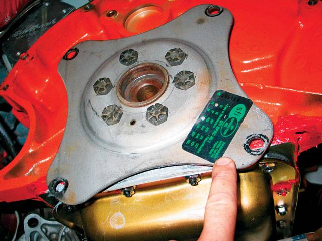

If you look at 1968rt's pic, I wonder if something could be trapped in that pocket beside starter mount?
grasping at straws lol

It does look like the flexplate is hitting something.
I put some sharpie on it to make sure the damage is fresh, and it is.
All the bolts seem to be snug. What else is there?

Looking at all the random shiny nick marks on the torque converter and edge of flex plate, something has either come loose or got in there somehow and is dancing around when running.
But it’s a banging sound. Frequency of the bang goes up with rpm.
See post #35... no point going forward here in the guessing game until you do that. There's a bolt or nut sitting between crank and starter that's beating that flex plate. Gotta be.... or the camshaft block plug is sticking out, there's nothing else..
