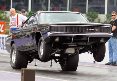

What kinda wheelie bars are these?

I can't figure these out. Looks like they'd tear up the track and be illegal. I've never seen any like these, unless they are a bad photo-shop. Anyone got info on these?

You sure they are wheelie bars ? They look like a chain hanging down to me. Maybe he uses them to tie the car down on the trailer ? Ron
They are actually look to me like,
the mounts that are welded on the rear end housing,
for a specific set/style of wheelie bars, maybe the flat spring style ?
no the wheelie bars themselves,
he/she probably removed the bars, left the mounts, for big wheelies it appears like...
I think Budnicks is correct, those are the lower mounts for the old comp engineering universal style wheelie bars. I have a set hanging in the shop.
yes rear housing wheelie bar mounts. he's just not mounting the bars on them. looks weird right?
mine are different but similar
Budnicks is right, he just took the bars off.,.. and they look like a chain because they have lightening holes in them. Thnx guys that was buggin me.
Very interesting, I didn't recognize that at first. They hang so much lower than the lower mounts I had on my Arrow. It had flat alum stock going back to the actual "wheelie" part which triangulated above the axle housing.
