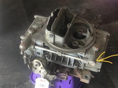

They both have mild 360s with the most basic of all Holley carburetors, the 600 4 barrel manual choke, list 1850.
Sort of like this one:

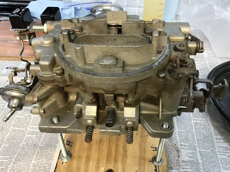

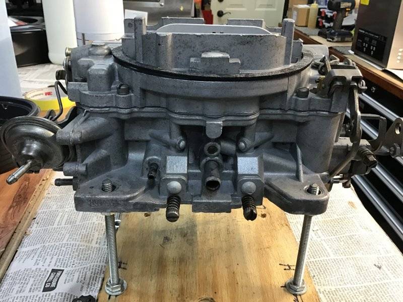

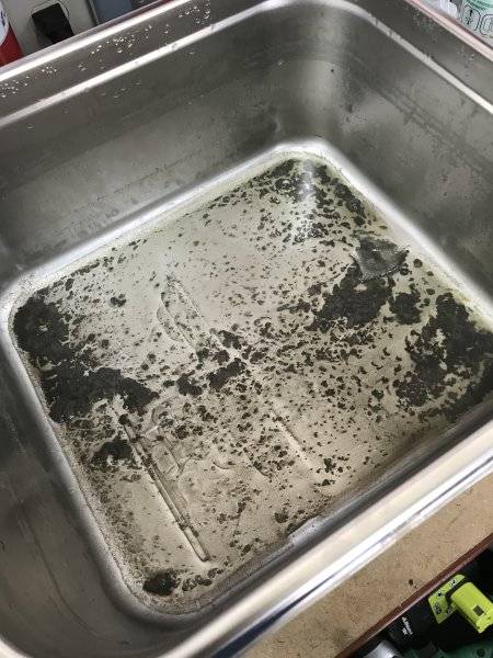

I recently bought an ultrasonic cleaner and ran an old AVS through it. I took it off my 67 about 20 years ago and it ran fine. It came out looking clean but I wasn't amazed until
I drained my machine. There was probably a solid 1/8” of seediment on the bottom from cleaning it. I wish I had taken a picture before most of it flushed out the drain as what’s in the picture below is just a fraction of the sediment. It doesn’t do anything for rust on linkage - I used some Naval Jelly for that and the stains in the bottom of the fuel bowls did not lighten up.

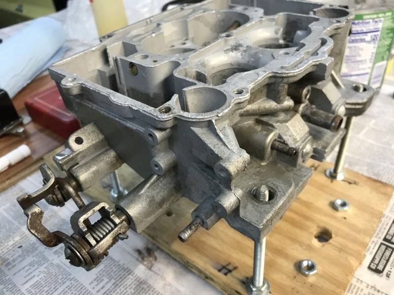

One of the problems with Holleys are that that they warp. Then you can rebuild them all you want and they don't work worth s**t.

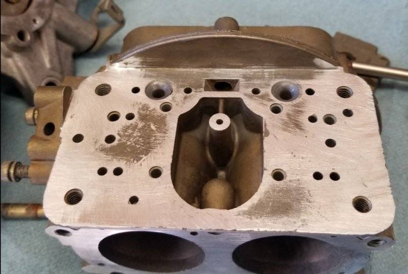

Once you get the main body separated check it for straightness. I'll almost bet that the body, behind the metering blocks, is warped (this is because people tighten the heck out of the fuel bowl screws). If it is warped, file or sand it until it's flat. Check also where the body connects to the throttle plate, although this area is much less problematic.
Here are a couple of pictures to explain what I mean.
This is near the beginning of filing. Note the dark areas that have not been touched, and conversely, the edges that are high and therefore have been filed.
Here is another carb near completion. You can still see low spots.
Bottom line is be sure the body is flat! If it is not, then you may end up with internal leaks that will make the carb impossible to tune!
