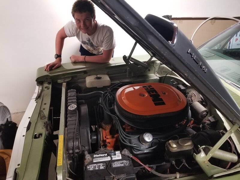

SO, I recently bought a 1969 Superbee with a 426 Hemi, but it turns out the engine was once set up at 13:1 Compression. However, it has since been sleeved so that it's now 10.5 to 1.
I'm still working on getting the car all back up to speed (mechanically), but my question is "Does anyone here know (or have a history of trying to run) what Octane Level I'll probably need to run it?" Back when I though it was 10.1/4 to 1, I was optimistic that I "might" get away with 91 Octane pump gas, but now I'm not so sure that's even in the cards. Also, as a side note, are certain brands of 91 Octane closer to actually being 91 Octane than other brands? Thanks for any insight you guys can provide. -Cheers
(P.S. that's not me, ...it's my 14 year old kid, salivating.)

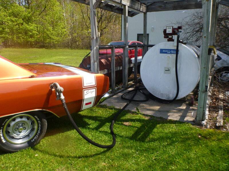

I have gotten away with 10.5-11 to one with iron heads, on West coast cat-pee 91, BUT... I had big camshafts, and barely streetable torque converters. Now that I have access to 100LL avgas, I run 50/50, cause I can (and AZ avgas is cheaper that Cali 91).
If the op has access to avgas, that's what I would recommend. Otherwise, a couple gallons of 110 added to 91, as others have said. Save the hemi, don't detonate!.
(Look for a tiny local airport with a self serve credit card pump, and bring gas cans. DONT put it straight into your bee)
I can do the same at our local airport as well, but of course I know the manager. At 2 bucks a liter they don't really care who or how they sell it...
The airport I get mine at, told me they didn't care who bought it, and I could tell anyone interested. The airport I previously used told me just the opposite, but it changed from private ownership to a county owned facility at the same time the pumps were upgraded. Plus they moved the pumps to where it would be a 1/4 mile hike to fill any containers.
