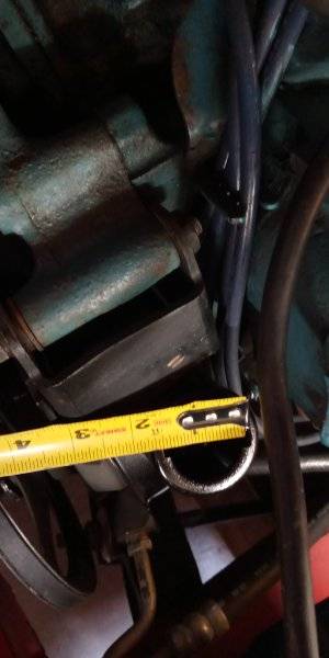

Hello, I'm trying to find a power steering reservoir cap. Have been searching the internet and parts stores. I can't see any identifying markings on my pump. Hoping someone can tell me what I have and where to find a cap.

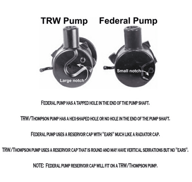

Federal/TRW. Caps are avail on places like ebay but rather expensive imo.
Federal and TRW pumps take different caps. Although the two pumps look similar, they use different mounting brackets as well. Pulleys and guts are not the same either.
