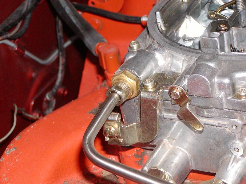

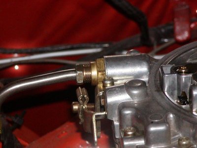

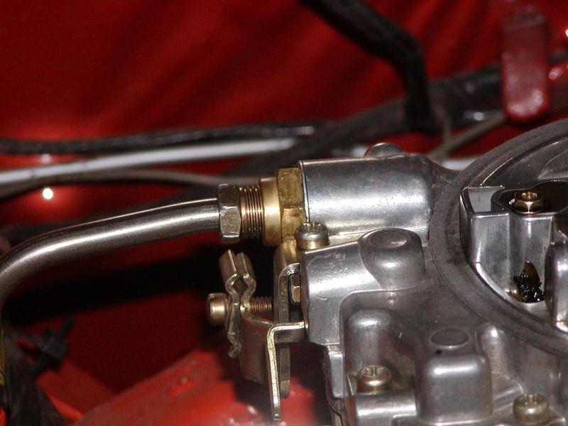

Hey Mechanic. Got your PM. The adaptor fitting was on the car when I got it, so no idea where it was bought from. Carb is an Eddy 1407 as well here's a couple of pics.
I know the have the fittings at Summit. I had to find adapters for my carbs to go to an lines.

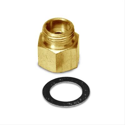

I think I found one that will work. Edelbrock part #8090.
Carburetor Inlet, 5/8-20 in. Male to 3/8 in. Female Inverted Flare, Brass
Carburetor Inlet, 5/8-20 in. Male to 3/8 in. Female Inverted Flare (IF), Brass

The Edelbrock 8090 is 3/8 IF by 5/8-20 male. But, my fuel line fitting is 1/4 IF. So, the search continues.

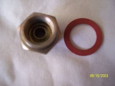

I ordered Dorman 55126 from RockAuto. It has two fittings for a 3/8" line, which is what I have. One of those should fit. Fingers crossed.

I wish I would have purchased the one with deep threads. As it is, half my fuel line nut sticks out but I think it will seal.
