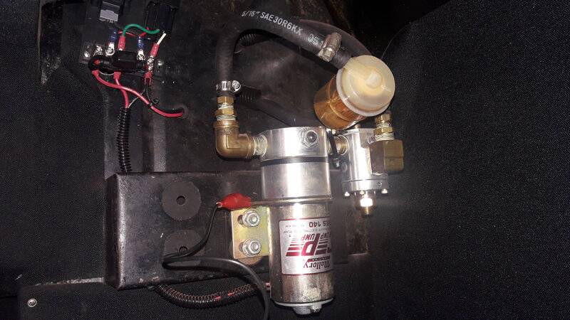

My car has
1978 Monaco 360 engine.
Mopar Performance Cam 4452761.
Summit Racing Carb SUM-M08600VS. 600cfm
Distributor Pertronix PNX-D141701.
Coil Pertronix PNX-45001.
and a Mallory 140 Comp Pump in the trunk that is mounted upside down for Heaven's Sake! No idea why the PO fitted it this way and I think it's dangerous!. The pump has an external regulator. The pump is also very noisy. So I am thinking of replacing it. I think the carb wants no more than 7PSI and maybe a bit less. Does it really need a pump with 140gph throughput? Can I go with something a bit less potent (and therefore cheaper)? Wouldn't 50 or 60gph be plenty for this engine? Or am I misunderstanding this whole thing?
Any thoughts will be appreciated.
David

The factory mechanical pump will easily feed your combo.

I am a huge fan of the Mallory 140 pumps. They are a gerotor design (similar to big block Mopar oil pumps) and superior to the usual vane type pumps, and quieter too. If it were me..... I would re-plumb it right side up, and rubber isolate it, with isolaters from somebody like Mc master Carr.
That said, you don't need that much pump. You could get by with either a Carter Universal ($42 at summit) or a Carter competition series (preferred, at summit $65). Neither needs a regulator.
If noise is the concern Edelbrock makes a "quiet flow" electric, but it is NOT cheap. For the money they ask, it better sound like a whisper.
Then of course, there's always a decent mechanical......
(The last pump I bought was a trick flow 140/regulator combo for around $125. I'm happy. About a third of the price of the Mallory. Holley bought mallory... and wants to sell HOLLEY pumps)

Agreed but it and its fuel lines have been removed and I'd prefer to replace this electric one rather than redo the lines again.
I might try it turned right way up but will also look out for electric 5-7psi and <=60gph pumps.

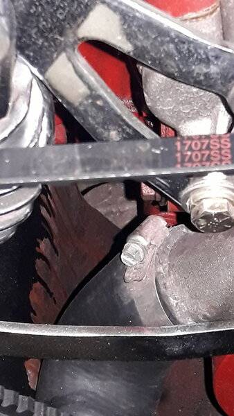

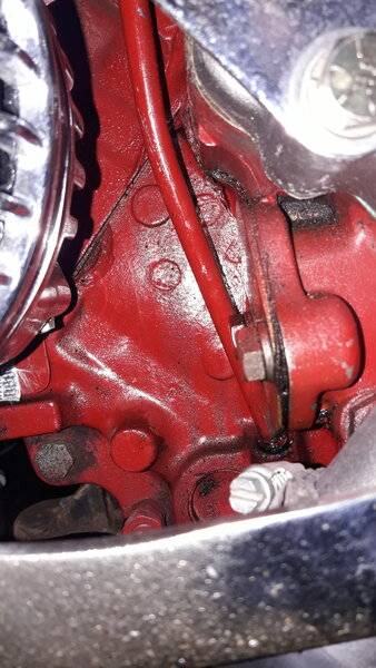

yeah, I know but there should still be room I would think. Look where the block-off plate is now, and check access.
As far as I can tell, clearance is not enough. The alternator on my car is fitted on that side and it's just under 3" from it to the blanking plate. It also looks like the coolant pipe from the water pump is going be an issue but I assume a mechanical fuel pump can be made to fit with it since it left the factory with one.
