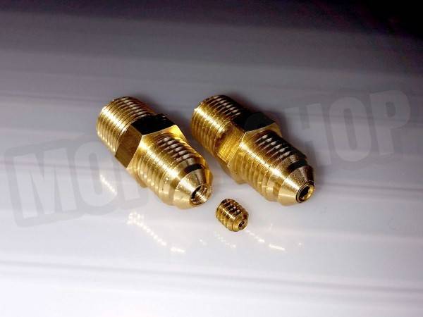

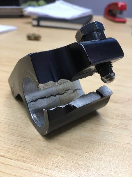

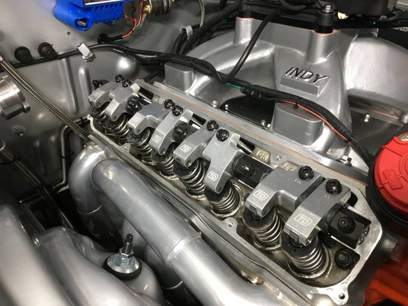

I'm having an issue with very low oil pressure at idle (like 9psi hot) after installing T&D Rockers. At 3,000 it's up to around 45 and I'm sure there is a ton of oil getting to the head. I am running 440-1 heads that are full time externally oiled. Before the T&D setup I was using the crap Indy Black rockers and tore the bottom out of an intake rocker. But even then idle oil pressure was maybe around 17psi hot. I do not currently use any restrictor in the lines but think this may help. My question is what size restrictor to use, .050 - .045 - .039? Been looking around and don't really see what I need. After shutting off the motor you can actually hear the oil running back into the pan.
I found this restrictor from INDY and I'm going to make it myself but I don't see what size orifice they use. Also here's a pic of the Broken Indy Rocker and New T&D Setup.

.045" to .050" is lots, you just don't require that much Oil for lubrication up top, it's more the cooling of the V/Spring the Oil provides you should be concerned with IMO, especially for street usage ? if you are attempting to run 200+ Lb Seat Pressure/550 Lb/in rate Race Roller profile V/Springs on the street, which it looks like you may using ? by the look of the broken Black DOVE Rocker ?

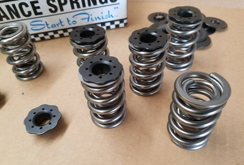

Street Driven, Milodon Pump, Externally oiled Mildon Pan, 235lb seat 650lb over the nose @ 1.910 installed PSI Endurance Springs, Current Orifice feed hole is .107

I usually set them up at .060.
I’d start there, and then if it hasn’t improved the pressure enough try .050.
I’ve never had an oil pressure problem using .060 destructors.
I believe the ones from Indy are .040.

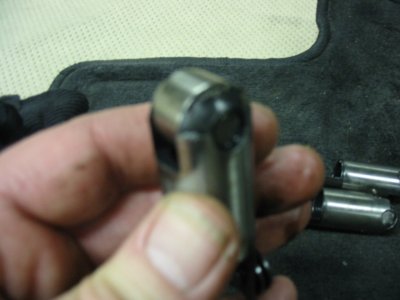

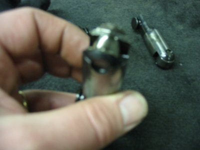

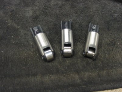

And yes, as mentioned above, certain lifters in certain blocks can really dump some oil around the lifter wheels when the lobe gets near full lift.
If you have the valley cover with the removable panel, and look in the valley around the lifters while priming and turning the motor over at the same time....... you might be unpleasantly surprised at the amount of oil hemoraging out around various areas of the lifters.

Indy EZ-1 heads - internally oiled BUT full time oiling. Harland Sharp roller rockers - so you know there's a lot of pressure loss there! I use a standard pump - not high volume with a Milodon pressure adjuster on the pump. External oil feed pump cover. I had what I considered HUGE oil loss around a set of roller lifters and switched to a set of Cranes that have the roller wheel shrouded to prevent uncovering the galley at lift. I put .062 restrictors in "just in case". Have only primed the motor at this point and have good oil pressure. Its amazing how much flows out around the lifters though !!

I set one up at .040 with t&d’s. Haven’t had it apart to see how it looks. The Indy rockers on my rr needed .060 to get enough oil
Frankly, the description you gave from what the guy at Crower said makes me scratch my head.
The picture would be made crystal clear as to whether you have a problem with those lifters in your block by doing like Bob and I said.
Prime the system and watch what’s happening in the valley.
If you don’t see oil gushing out from below the lifters when they are near full lift(and you have to check every one), then you’re not having that problem.
But...... I’ve seen a stream of oil as big as my thumb run out from below a roller lifter on one of my 440 blocks....... and that motor actually had decent oil pressure.
If it would have had a few more holes that leaked like that....... it would’ve been a problem.

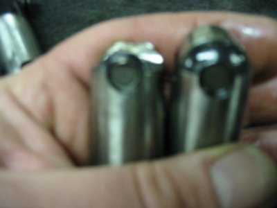

The rollers I initially used had no shrouding around the wheels - much like the ones's in your photo. With a .600 lift cam they were exposing the galley at full lift. The Cranes I bought have the shrouding on one side of the roller - the side that sees the larger cross section of the galley at lift. The shrouding goes almost half way down the wheel. Even the other side has more shrouding around the wheel than yours.
The pictures of the lifter were not mine. I didn’t post pics of my lifters Hemi-itis did.
