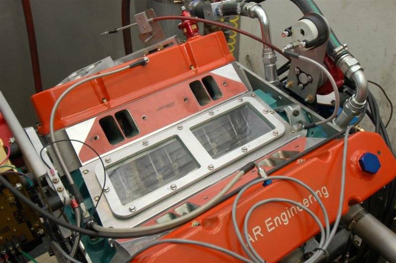

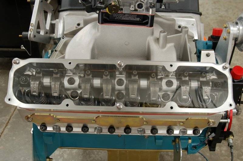

The bottom line is that you can't go by what anybody is telling you, you just have to look at your own engine to see what the issue is. We all have lots of experience with these engines but nobody on here knows what your lifter bore clearance is or what the base circle on your cam is or things like that. If you have a tolerance stack up issue then you'll have to find it and solve it by looking at your parts. As people have pointed out pull the cover and see what is going on. If it isn't leaking a bunch there then it is probably the top end. Over the years I've solved these problems by using clear valley covers and clear valve covers.

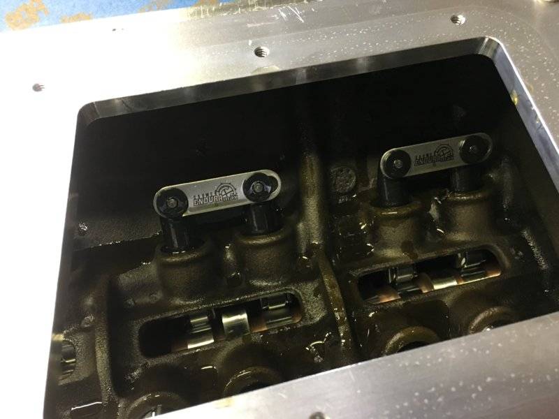

So let me pick your brains. I am having multiple issues that changed once I went to the TD setup. Oil Pressure aside for the moment (although I did install the .063 restrictor in the line and pressure is up to 18-20psi at hot idle, 45psi @ cruise, and 65psi @ 5500, and when I pulled the valve cover oil was still flowing over the rocker at a good rate, even pumping out onto the header, to the point I had to shove rags in there to stop the mess) but anyway, I having very, very, noisy valetrain. Starts with you basic solid lifter tap cold, but gets much worse as it warms up. The old Dove rocker were also loud but not like this. It's very irritating to drive. I assumed that going to the TD stuff would quiet things down a bit due to tighter side clearances and nylon type spacers, instead of metal shims, but it's louder then ever. 440-1 Heads, My spring diameter is 1.510, I'm .120 from coil bind w/.030 shim to get it there, the valve tip extends plenty far above the retainer. The pushrod is 3/8 in diameter, the cam is a .262/.262 @ .050 .645/.645 as speced by Dwayne Porter. I have very little side clearance with the new TD rockers probably 0.00 clearance to almost tight on the middle pairs for 3,5 and 4,6 I even clearanced the pedestals some to make it better, you can actuate the rockers by hand but there is drag, TD said this was OK and that they would burnish in????? The lash was initially set .018 cold, then checked hot, it opened up to .025-.026 so I lashed them back to a tight .019, cam card calls for .020. I just don't know what it could be!! I did notice the intake rocker pushrod for #5 cylinder felt like it could be close to the head but I didn't see anything rubbing. Also it just runs funny and my fuel injection needed to be tweaked to pull fuel at idle. One other thing is the car always smells like it's running pig rich and waters your eyes, but my laptop tells me the AFR is 14.5 at idle. Looking for some guidance.
