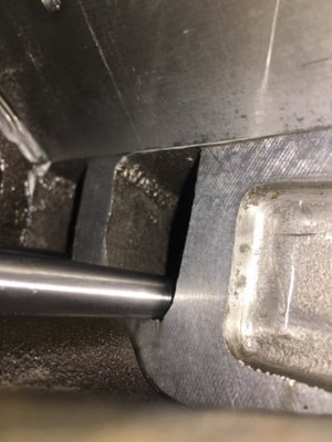

So I opened up the engine and checked the oil flow around the lifters, and even at full lift none of them are really getting a much oil coming out around the top or around the pushrod either at max lift or on the base circle, BUT there does seem to be a pretty good stream running out the bottom that really doesn't change much whether at lift or on the base circle. looks like it's pouring around the lifter onto the cam at a rate of maybe a 1/16 thick the entire circumference of the lifter (if that makes sense) but doesn't really change by moving the lifter up or down in the hole. I'm posting a video of the bottom of the lifter on the base circle because actually, it seems like it flows a bit more oil more there I can tell you that even with .060 restrictors oil is pouring down the side of the block first in the back then down the middle at a pretty good rate. let me know what you think.

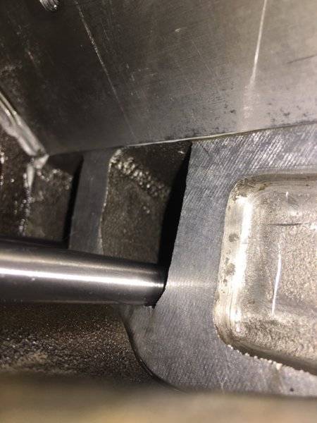

And I think I found the noise.....
As for the oil flow out from under the lifters...... yeh, that’s pretty bad.
As well as how much is running down from the heads.
How many of the lifters gush oil like that?
Just imagine how bad it is when the oil is hot and it thinned out.

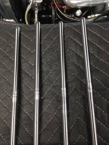

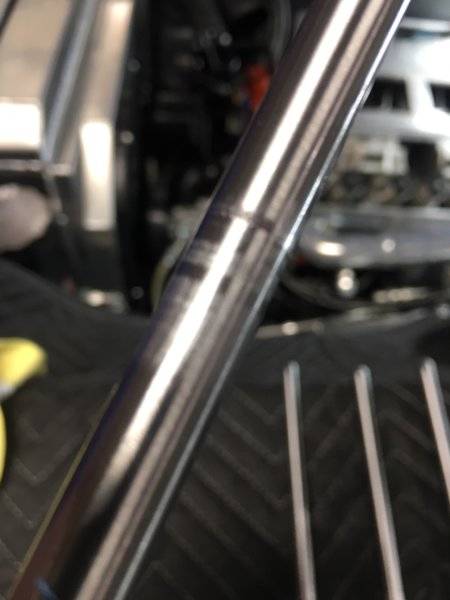

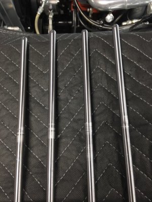

The pushrods rubbing there...... “normal”(not good, but it is pretty normal if they’re not clearanced)........ that’s why I always clearance them.
There is likely some binding when the pushrod is trying to seat in the rocker adjuster, and you’re getting a false lash reading.
You’re setting it right, but the pushrod likely isn’t fully seated in the adjuster, so there is actually vertical clearance on the pushrod side of the rocker.
The good news is...... after clearancing it should get quieter.

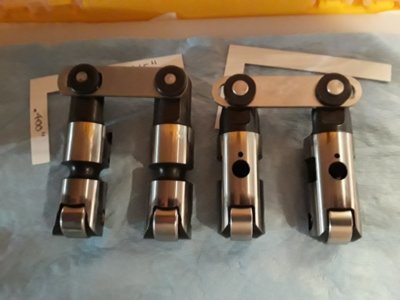

Here’s a couple of questions for Bob......

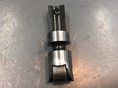

Do you have an idea about how big the EDM holes in those Crower lifters are that feed the bushings?
Is there only one hole, or one on each side?
Looking at the pics of the lifters a bit more....... it seems like if the problem isn’t the wheel opening being exposed to the gallery at high lift that’s causing the problem(which apparently it isn’t since oil seems to be flowing pretty good at any lifter position)...... is all that oil flowing out the bottom coming from the feed holes to the bushings?
The more I look at those lifters, the more puzzling it seems that there’s so much oil flowing out the bottom with the lifter down near the base circle.

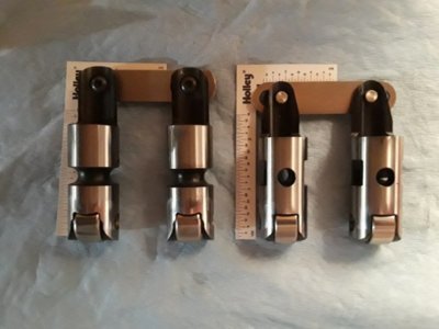

For comparison, BAM BB Mopar lifter on the right:
(Looks pretty similar to the Crower)
4539F9A3-6BF5-4A0D-8681-9937274554CF.jpeg 2FE5AA9E-99E8-4634-9B57-B9E6EB2A5222.jpeg
I just checked a Comp 87019 lifter, and the bearing feed hole is what I would consider as being “huge” for the application...... it’s .028”
These came out of a 572 I built about 10 years ago using an aluminum World block with bushed lifters........ and I don’t recall seeing anything alarming flowing from below the lifters when I primed it.

From an oil control standpoint, it’s going to be hard to beat the 829-16’s, since they have no holes and no band.
The only leakage you get from those of from whatever the lifter to bore clearance is......... except sometimes when how the oil gallery intersects with the lifter bore, you can get some oil flow out of the bottom(similar to what you were seeing from the Crowers) when you get the lifter up near full lift.
