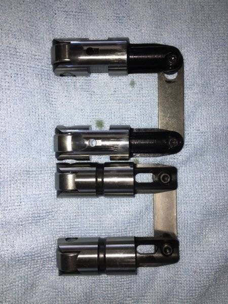

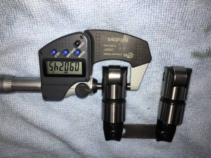

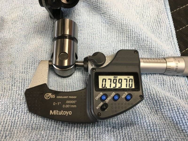

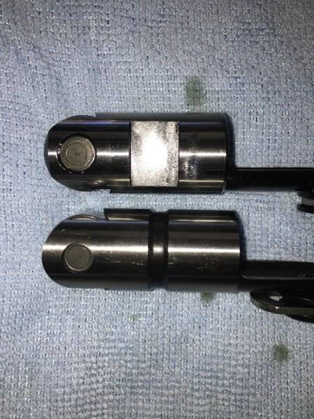

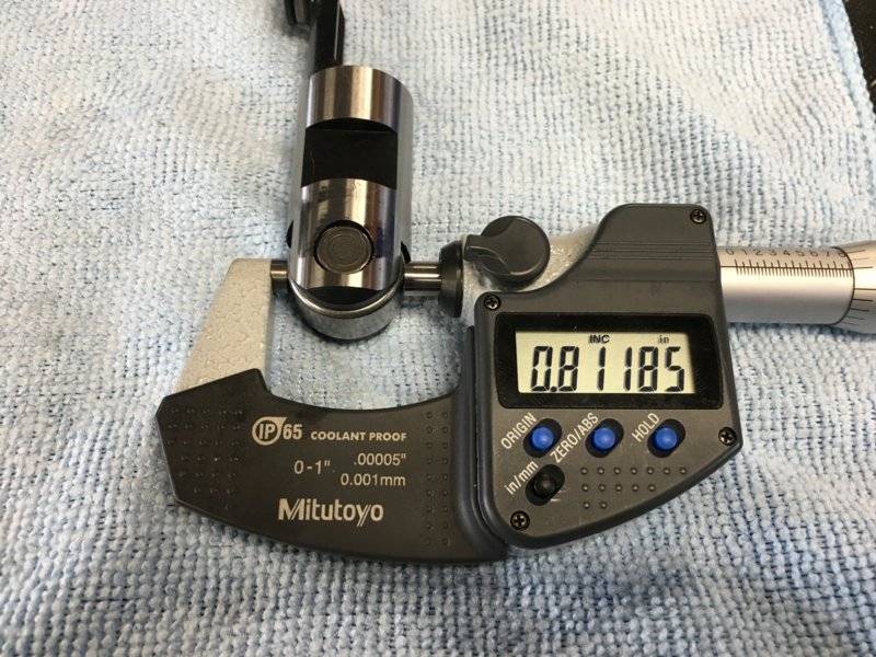

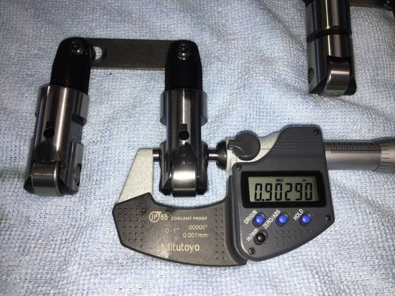

Here's a couple pictures I took to compare the 2 Lifters.

Yea, I was hoping the body diameter of the Comp lifters would have been a bit larger then the Crower but the Comps are actually .00045 smaller, Which is a minute amount I know, but still. They felt good in there. Could it have been a .001 tighter probably, but nothing I'm going to fix at this point.
