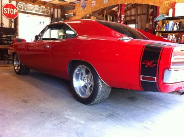

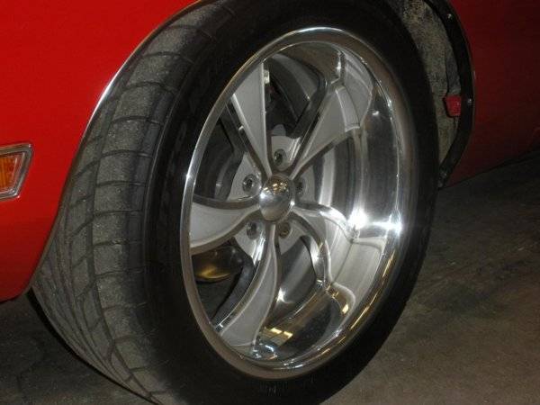

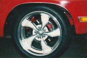

Take a bare wheel and mount it to the rear on both sides. There are enough variances in these cars that what is close on one side can sometimes make contact on the other/.
I have had success by seeing what already clears then theoretically adding to where there is room.
Example: If there is 4 more inches of room outboard, you could safely add 3 inches to be within a 1 inch margin. I did this with my 70 Charger and my wheels are just about the widest you can fit without cutting anything.

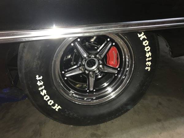

275/60/15 on my 67
15x7 4.5” bs
it’s real close, and a hell of a fight getting them on/off
