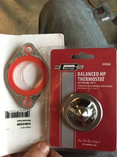

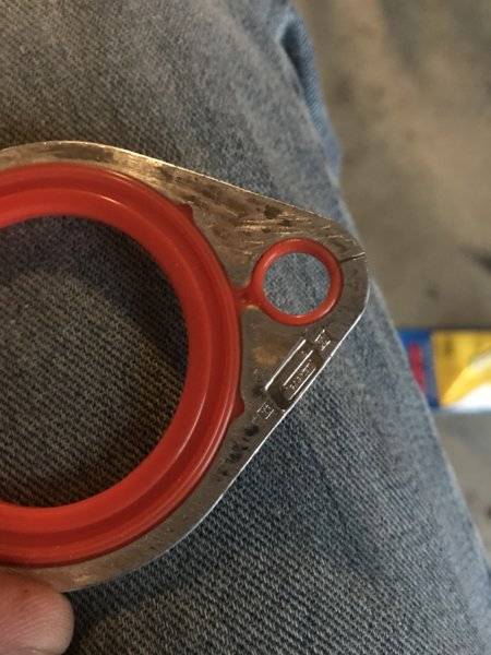

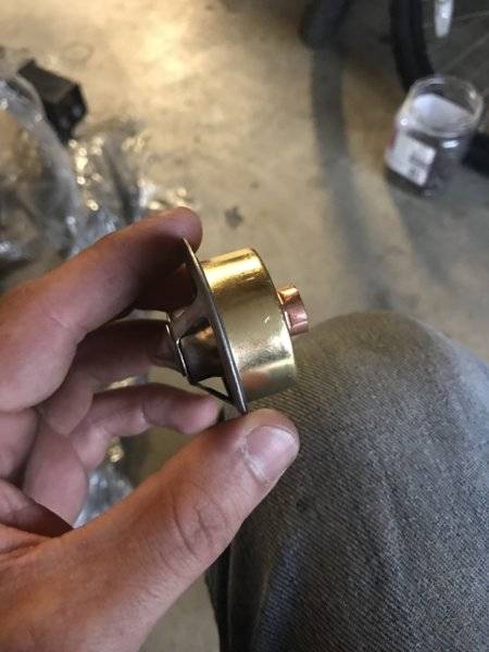

Got a mr gasket 180 thermostat and gasket from summit, gasket is real nice.
4B89D96A-240B-487D-BC4D-968A83E42EB1.jpeg 90D435AD-29FB-40BD-BADF-F2E709B54F51.jpeg 58C231CF-2F35-4AF1-ACF7-1A1F9C2A06BD.jpeg
View attachment 524027 View attachment 524028 View attachment 524030
I've recently had two brand new Mr. Gasket thermostats go bad. One I installed in a customers car and it never opened. I had a second installed on another project, removed it and slowly heated it up in some water on the stove and the water temp got to 270 degrees and the stat never opened. Ended up replacing one with a new Stant and the second with a Robertshaw and have had no problems since. Both were 180.
