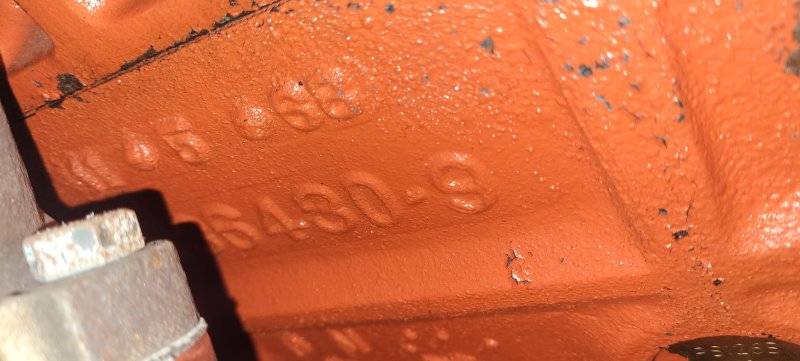

I just got a 69' Satellite with a 440 - 6BBL in it, not original to the car. I have researched to try and find out what engine this is but have came up empty. It's a 68' casting (I think) but I don't see HP stamped. Not sure what it is. Could it be a warranty block? No idea.
69 440, there should be so stampings on the passenger side pan rail that will give additional information.
It simply Designated the 375 HP version with the bigger camshaft.
HP1 or HP2 were just designations of what shift the engine was assembled.
Check the side rail = Engine was probably out of a C body/you can tell from the VIN
HP stamping has no significance on block casting or strength despite some if the
Fairy Tales that have gone around the last 50 years!
11-5-68 casting date = 1969 model year engine: "E" stamping = 1969
no HP stamp = 350 h.p. Only difference was camshaft and no windage tray,
Holley carb, instead of Carter AVS.

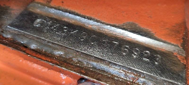

1969 x 440, probably out of a C body being a non-HP. Check the VIN stamp on the passenger side just above the oil pan.

Ok, so finally I got under to verify block numbers the best I can.
What I read is C143K9C176923
If this is your number, come forward with your ticket to claim you prize lol.
CL43 = Newport Custom four door HT
K= 350 horse 440-4
9= Model year 1969
C= Jefferson plant
176923 = remainder of VIN
