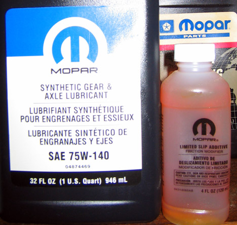

It appears that aidditive is a Mopar product and comes in a 4oz bottle. Regardless whether my rear end is a sure grip, posi, power lock, or trac lock, would this product be used in any of them?? Also, would you recommend 1 or 2 bottles (4oz or 8oz)? thanks, Richard
Use the whole bottle then fill with gear oil 75-90 gl4 is what I use.
You can use any friction modifier from any company, they all do the same thing, just buy high quality.

Thanks for helping. I got a lot of responses when I originally posted my thread on what axle lubricate to used in my R/T with the Dana-60? I got a lot of different options, and I think any of them would work. I decided to try Mopar 80w-90 axle lubricant and Mopar Friction Modifier". I kind of thought who knows Mopars better than Mopar??? Mopar's 80w-90 axle lubricant was a bit expensive, but how often do you change rear axle lubricant.

I tried the Mooar additive and my clutch sure grip chattered really bad, switched to the Ferd stuff, and the chattering disappeared.

I think if you are starting from no oil in the differential, you are doing the right thing. I started with a complete re-built 742 sure grip, including the clutches, used non synthetic GL4 oil and the Mopar non synthetic sure grip additive ( Mopar friction modifier) Mine works just as Ma Mopar intended-perfect.
