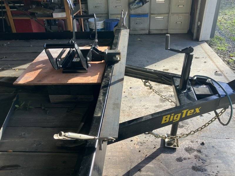

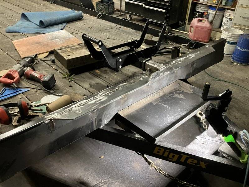

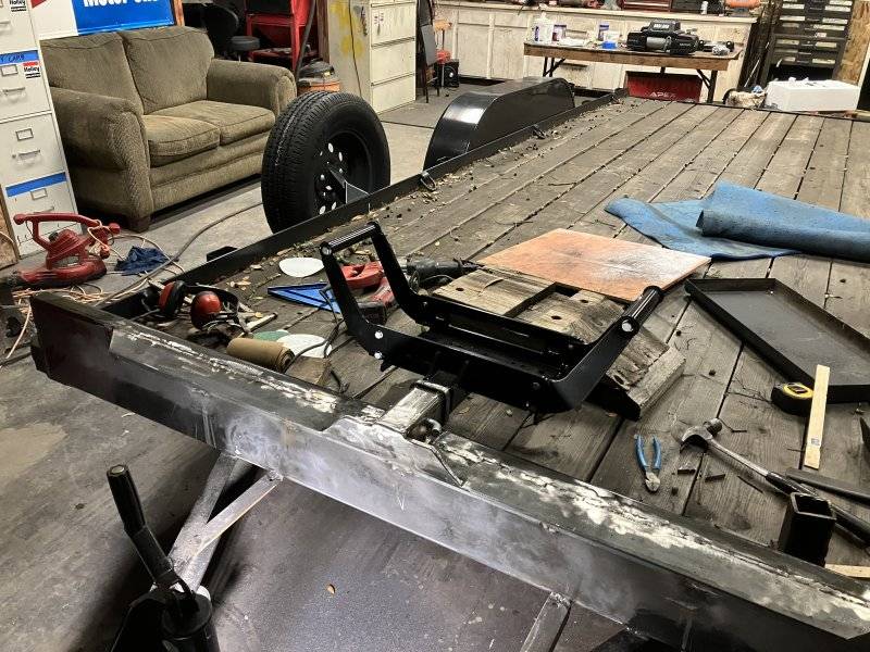

I got a chance to build the supports and hitch mount for the trailer.

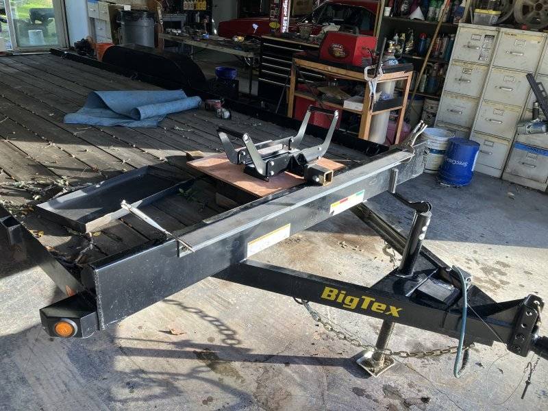

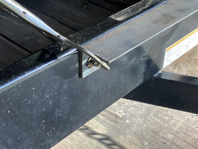

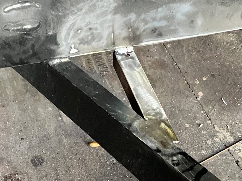

To keep the front rail from bending while winching, I used a 5 foot section of 3 x 3 angle steel.
The deck is 7 feet wide so this will be fine.

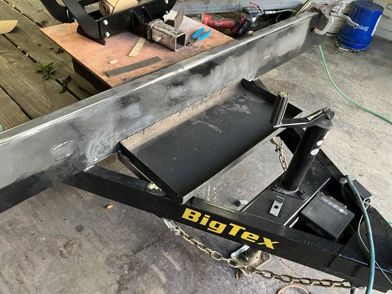

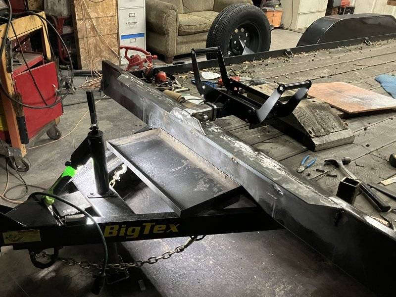

The frame rails got 2 supports to put in a tray that I'll use to place the battery.

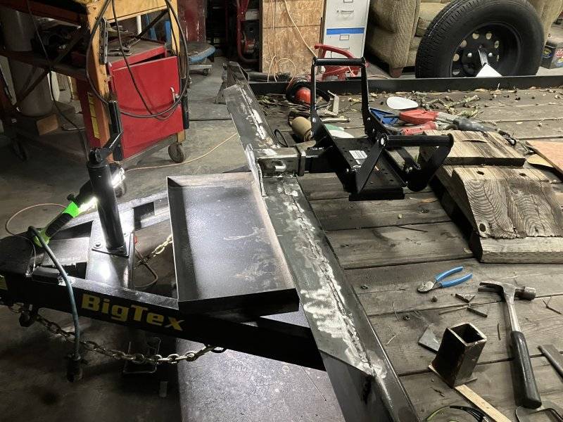

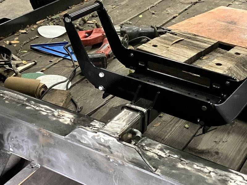

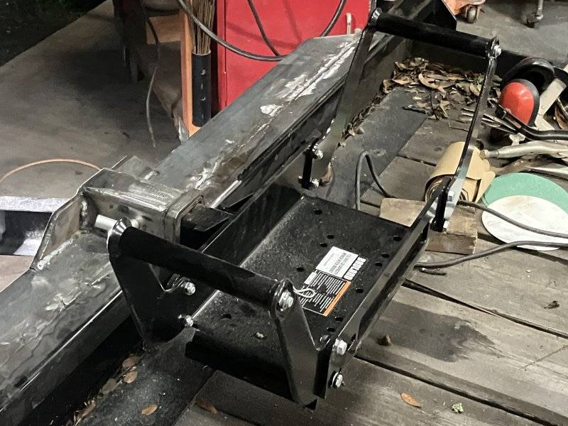

The angle steel is in along with the hitch mount.
Hey...I'm a Carpenter, not a welder/fabricator but this should be pretty stout.

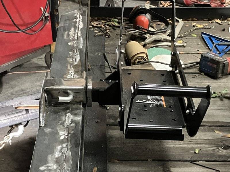

Your trailer mount is plenty strong, overkill in fact. The winch mount looks like mine, if so, it's plenty strong too. The first mount I used got twisted, which in turn twisted the winch.

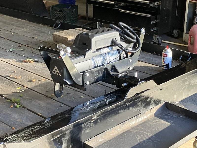

Ta-Da !
No, not the beater Duster on the left…the winch!
This dude IS heavy but I’ll just deal with it.
Next up, I have to power it up.

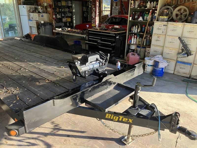

The fit is good. The trailer has an 18’ deck so it looks like I’ll be able to pull a car or truck all the way onto the deck and still have room to pull the winch out if needed. The car can then be pushed or strapped further forward as needed. Ideally I would have liked the winch to sit on top of the front rail.
That would allow me to have absolutely no problem pulling the winch with a longer vehicle on the deck. I’ll make this work.

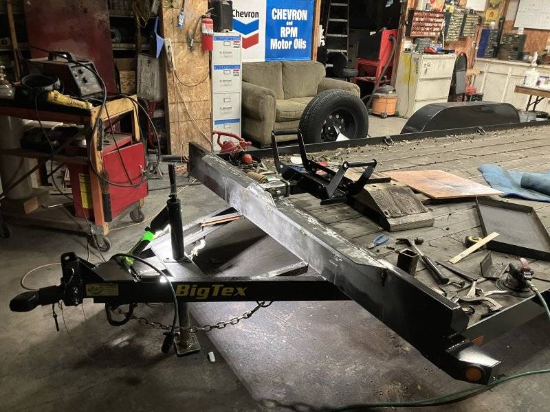

I've messed around with welding stuff for years and have always had mixed results. I'm actually taking a welding class starting in a few weeks.
I'm a bit concerned about the weight of the saddle and winch together. I'm wondering if I went too big with the 12,000 lb unit.
I should have the winch mounted to the saddle tomorrow, then I'll figure out how to power it up.

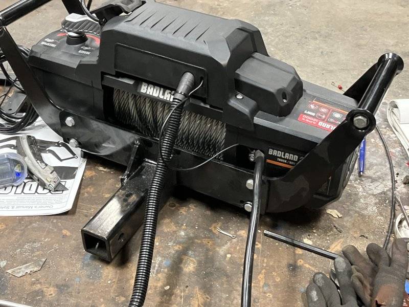

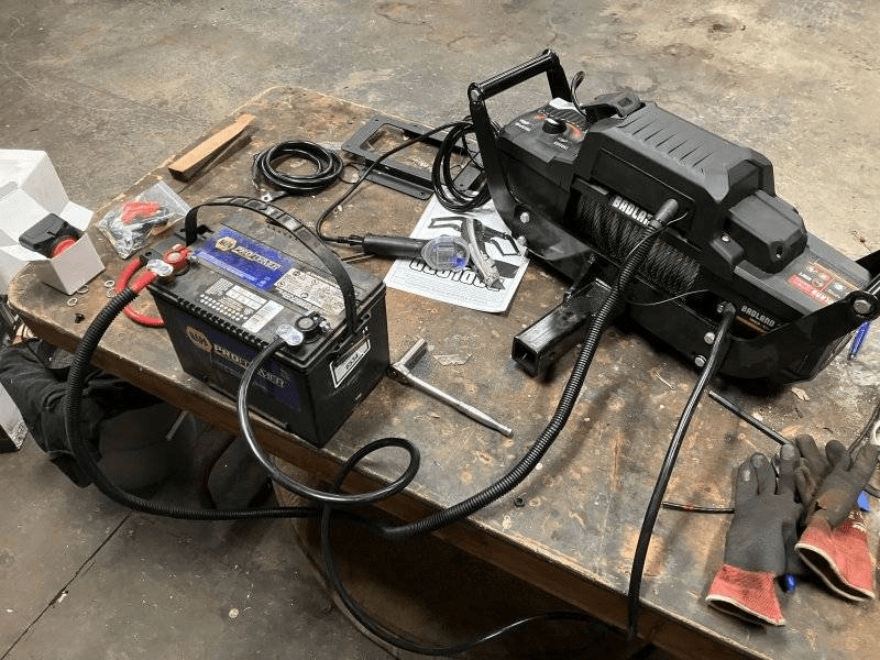

The winch came with some parts that were not used. It feels odd to have parts left over but these were for those that wanted to relocate the control box for whatever reason…
Otherwise, the wiring was simple.
Positive on the left, ground on the right.
They supplied cables. I cut the ends off and used these:
The unit comes with a corded remote that can also be used from A limited distance when disconnected.
I reeled it in and out a couple times. Maybe I’ll put it to a test tomorrow.

Winch, saddle, cables and remote weigh 112 lbs. Good thing I'm not some 98 lb pipsqueak!
This "remote" is connected to a cable but supposedly can be disconnected to be used as a legitimate remote though at a casual glance, it has no pocket for a battery so I don't know how that works.
