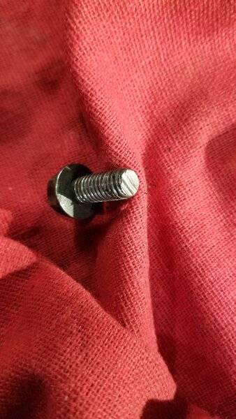

guess I ran a too long pulley bolt into the timing cover. Can I pull the damper, reset and torque back down or am I getting a new one?
That bolt was hitting the timing cover? If it didn’t rub a hole through it you’ll be fine other than cosmetically.

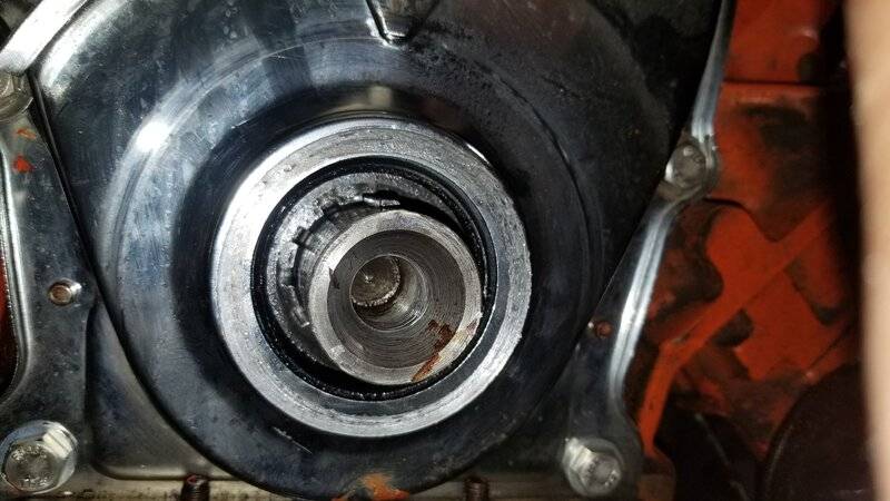

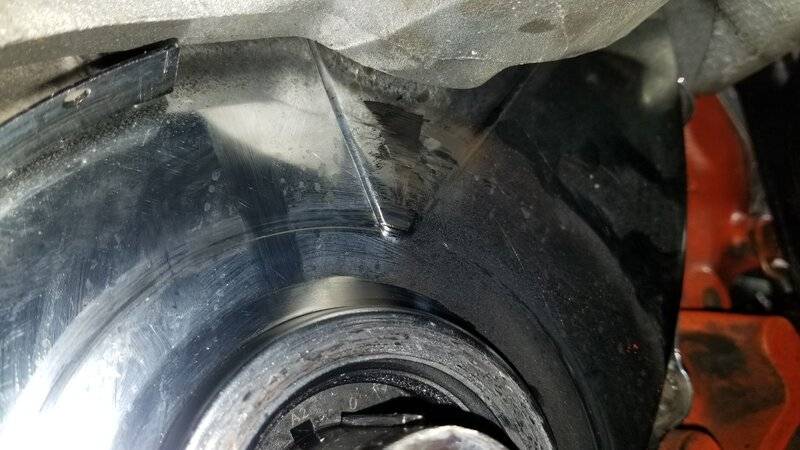

Didn't wobble prior to cam swap. Bottom not opened. Pictures show wear on close to half of back of damper and rub marks on timing cover.
How do I test this damper or do i just buy new? Or am i looked at bohica on the crank nose?
Looks like junk to me. The rubber between inner and outer ring looks like it is coming apart.
I believe the rubber smashed into the raised area on the timing cover and caused the crumbled look. The worst part of the rubber is where the “crusty” part of the outer ring is wore off. The seal lip is also wore down rough from where I had the too long bolt in it.
It's wavy on other side they're not made to be straighten out, if it wobbles it's NG. MO. Middle looks like spring from seal is laying on top of crank snout. You can't pull Harmonic damper by pulling on outer ring it could end up in two pieces.
It's wavy on other side they're not made to be straighten out, if it wobbles it's NG............ You can't pull Harmonic damper by pulling on outer ring it could end up in two pieces.
