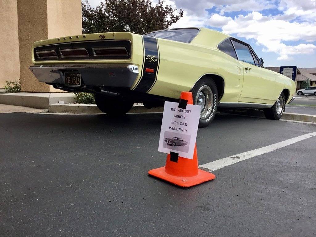

Inserted one Summit truck leaf each side. Resulted in just over 1" lift.
