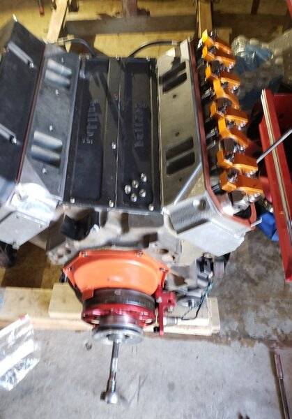

I would like recommendations on the BEST valve cover gaskets, when using Edelbrock Aluminum Valve Covers for a 1972 440 RB. There are many options, but I would like feedback on those that are considered the highest quality, best sealing, etc. Once Again, Thanks!
