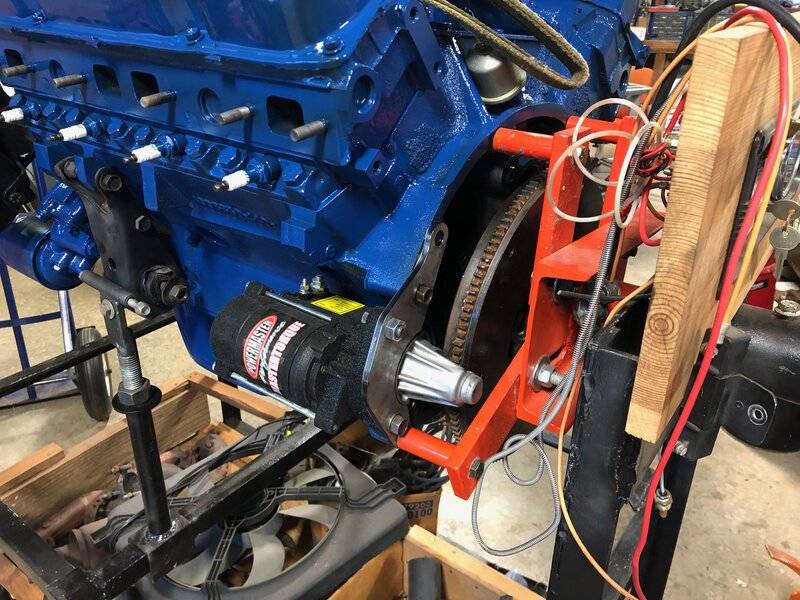

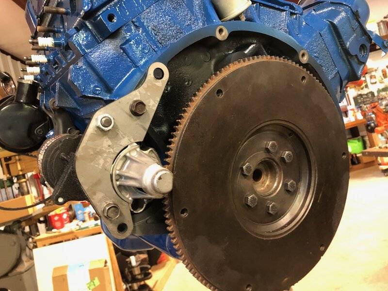

Got the starter mount plate from an ebay seller and got my engine with starter mounted to my engine run stand. Looks good and I think it will work just fine in doing a engine/cam break in run. Thanks for the help y'all.....
Looks good. I'd watch if there is any flex in the mounting plate. The nose piece goes into trans to keep the gear engaged. You could put something between block and other end of starter. Probably be OK as is.

If you look at the picture above you will see a round nose on the starter that part needs to fit into a matching recess in the bell housing. without that support the two flanges on the starter would see extra stress when cranking and will eventually lead to broken starter ears.
