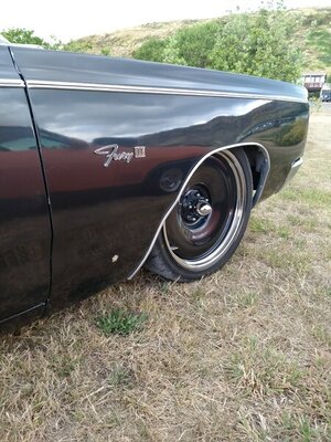

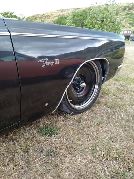

I've got 20x9 and 20x8 Detroit steels on my Fury.... Those are a real heavy wheels!

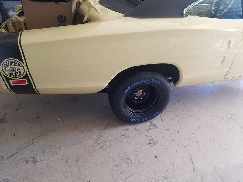

I have 15X10 with the 5 or 5 1/2 backspace Weldwheels on the rear of my 69 Coronet R/T, with 275-60/15. Fit great, don't rub anytime or anywhere.

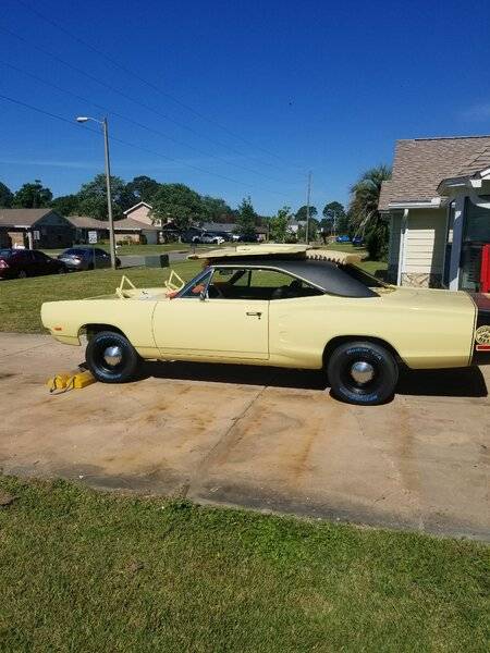

I'm running 15x10's with 5.25" backspace and 275/60 tires on the back of my 69 Bee. Has a Strange 60 with stock dimensions from Dr. Diff. Pretty much perfectly centered.
