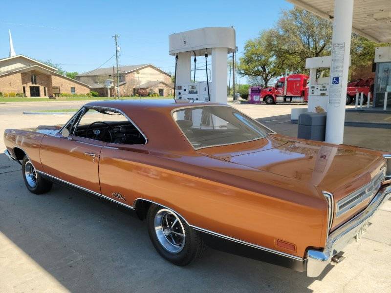

I've owned my '69 GTX since fall of '69 as second owner. Since it is a numbers matching car, I left the original 14" road wheels (see pic). I just decided to change wheels when I found a great deal on HK Magnum 17x6" wheels with 3.75" BS. (BTW...Summit Racing and Holley both have great deals on these wheels.) I'd like to know who has the same/similiar wheel specs and what size tires you are running on cars with stock wheel wells. Knowing the largest size that will fit will allow me some flexibility in tire choices. Thanks in advance for any feedback.

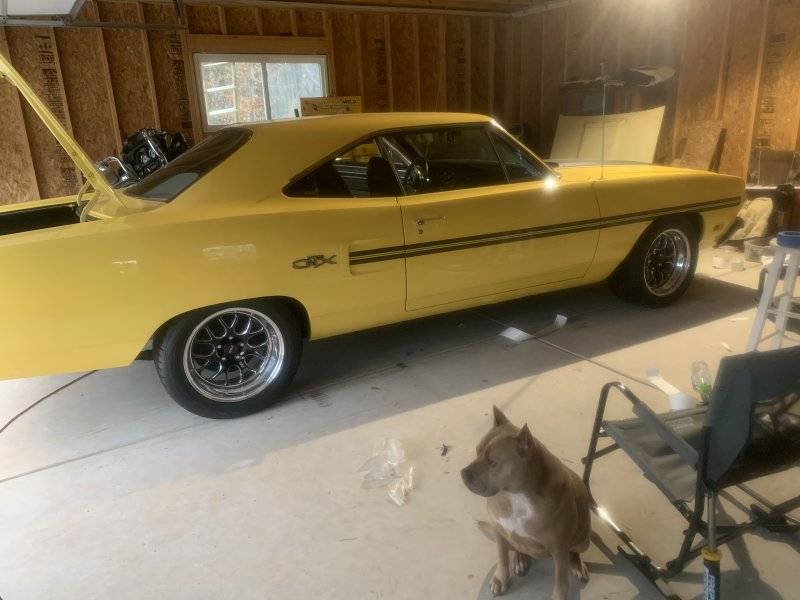

I went with 255x50-r17 all four( bout 28” tall ) 17-9 weld wheels 4.5 back space ,
