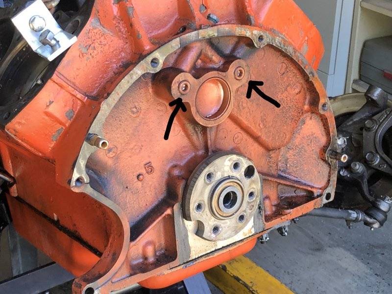

Secondly, the oil residue at the transmission bell housing area is most likely a rear main seal although the back of the engine does have pipe plugs threaded in as seen here:

I actually replaced the threaded pipe plugs when I had the engine out to clean the water jacket.

First of all, few of the members in the US may know what a "milliliter" is!
KD...You need two more
arrows in your sketch. One
of those ports are open in
your pic. Hint: (oil pressure
guage)......:)
I was referring to the leaks inside the bell, not around it.
I was doing a teardown on the block in the picture, hence the oil pressure sender was out.
Was just giving you a hard
time KD. I'm not one to say
"I gotcha", but approach
things from the humorous
side. Open ports spring
massive oil leaks.
