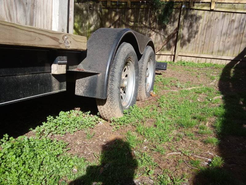

I have some 15x6 rims and have been looking at 205-75-15R-@27"tall tires for my 68 charger after thinking the ones on my trailer that size look about right. There seems to be not many available that aren't for trailers or have they have low speed rating. I'd like radials for sure. Any help, suggestions, info, pics, links, opinions, etc. will be appreciated.

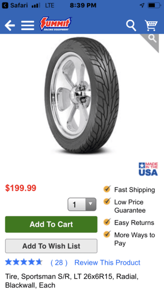

What is your rim width? I've been looking at those but noticed a lot of bad reviews from a while back, maybe they've got better. The ones I need for 6" wide rim are the Sportsman S/R, LT 27x8R15 which are $221 each, kinda pricey. I may end up getting them anyway, they are perty, and have an H speed rating 130mph.... Not a lot of street driving planned.

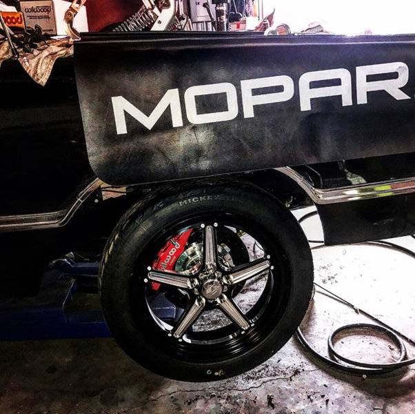

I put over 1000 street miles a season an hope to get to the track 3 or 4 time.I use E/T Street R in the rear and E/T fronts.
The street rear is 16.5 X 31.slick is 10.5W X 29.After a few tries the street rear did hook at 9psi.
