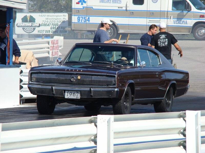

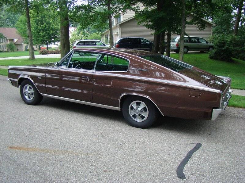

Thanks.
- I have no meaningful handling modifications
- Street driving with several trips to drag strip per year. Total annual mileage will be 2000 miles, max.
- I would prefer radial, mostly for safety reasons but if someone claims that the bias ply handle nearly as well, and the are stickier than their similar sized radial counter parts, I would consider them.
- 67 Charger.
I have BFG radials on the car now. P235s, but they are nearly 30 years old, and I presume that the BFG quality today could be different. Some have suggested that the BFG's today are not what they use to be.
The polyglas G70s is an option. Thanks
View attachment 1172969 View attachment 1172970
I would think going from a radial to a bias ply might be a bit of a change especially in a heavy car? Whatever though, sounds like it’s a nice weather driver so I wouldn’t sweat it any more than driving on 30 year old tires!
Out of curiosity, do you know what tires ‘67 Chargers came equipped with originally? Presumably 14” but maybe not? I know redlines were available but I can’t picture a Charger with them. Perhaps start your search there though and see if you come up with something along those lines. IMO The A-12 tires might not look right but something similar could work.
