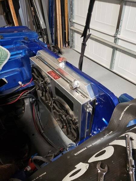

The other thing I forgot to mention w GLEN-RAY.... no measuring/drilling/calculating mounting . And still no fan clearance issues

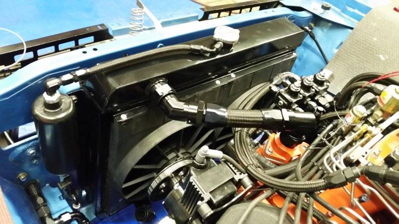

I had a place local who build custom racing and street radiator's called Superior Radiator. They built my custom but stockish looking radiator for my big horsepower street strip Challenger. Came with cooling flaps that open at speed and dual electric spal fans and shroud.
