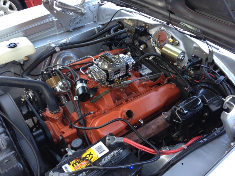

I can only give you my experience with the carbs i have used. Few years ago when my 440 was first fired up, I had an Eddy 750. Tuning wasn't too difficult, the car ran ok. The car seemed responsive, etc... Fast forward to the present, I was talking with the guys at dodgecharger.com and I was made aware of the performance difference between Eddy and Holley carbs. Long story short, the majority of 'Performance Oriented" gentleman the seem to run Holleys (Proform/Quickfuel) carbs. My take on the discussion was that Eddys are easy to setup and tune, not too performance oriented, Holleys take more time and talent to setup properly, but the performance payoff is huge. So I decided to buy a Proform carb, which essentially is a Holley but a little better design... After having a little help from a good buddy setting up the carb, replaced my power valve and a couple other adustments. I can honestly say this was a great change in my Chargers performance! That carb literally "woke up" the car. It is too easy to smoke the tires, this thing pulls hard, slams your a$$ in the seat! I love it, I would NEVER go back to a traditional type carburetor.

love the look of that carb. If you have a part number for it I can look into getting one if my last ditch effort fails. Where did you get that offset bracket for the coil? If I go to a similar setup I would love to keep the coil close to its present location and that bracket looks great. did you make it?
