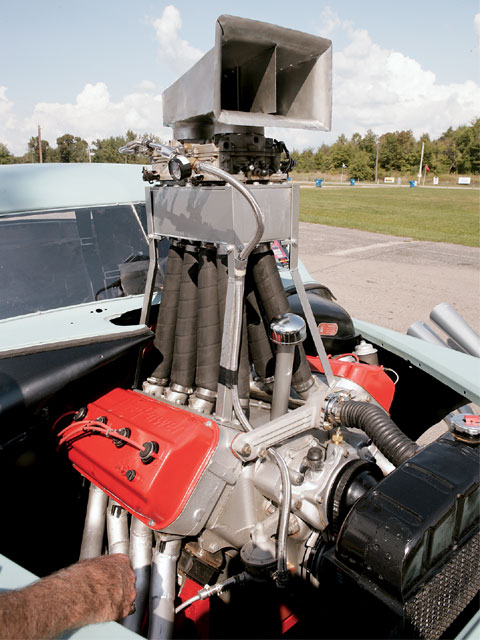

One of these might cause hood clearance problems.
