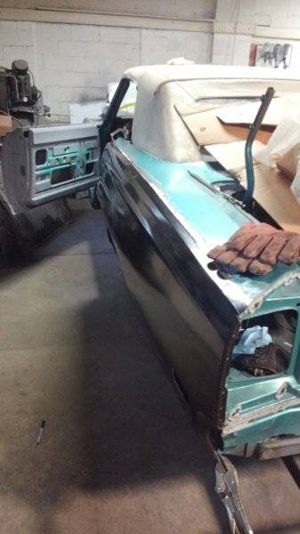

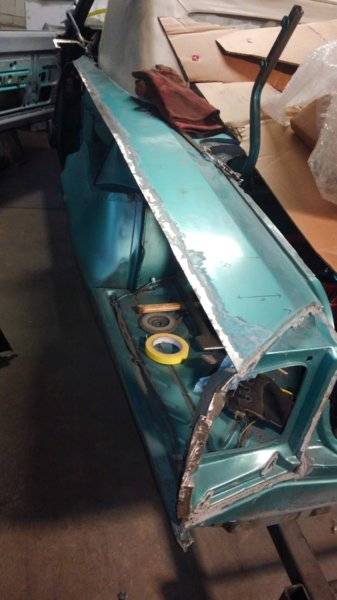

I couldn't agree more. I probably have 3 hours into file fitting the top of the 1/4, couple hours of tig welding and than hammer and dolly work.
