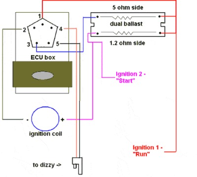

Does the blue wire go on the positive or the negative on the ignition coil? I took them off and mistakingly forgot.
the blue wire go's on the positive side of the coil hope this helps
maybe this will help

Appreciate it boys I spent 3 darn hours looking at pictures on google and found nothing but you guys definitely kudos.
