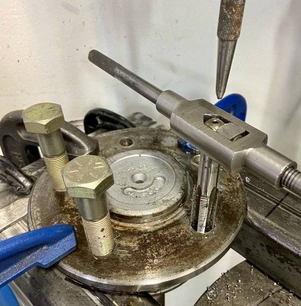

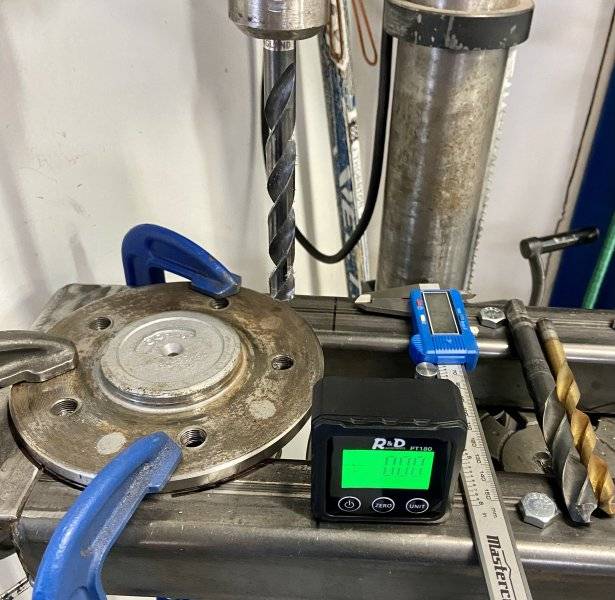

Today the axles came out of the Dana, time to upgrade to 5/8” studs. The 1/2” ARP studs that came out were straight, not bent at all, unlike the previous set.
I started off by making a jig that bolted to my old drill press base. 2X2X1/4” tubing, rock solid. Alignment with a 7/16” transfer punch that nicely slipped into the 1/2” fine threads.
Spent lots of time getting it dead set right and solid, end of axle below resting on a bottle jack.
Low RPMs and cutting oil
Studs haven’t shown up yet but when they do, ready to install.
Yeah the dead centre ain’t pretty but for today it kept the tap in line just fine.
3 holes finished, will finish up the rest tomorrow. Making progress. 727 Low-gear set is on it’s way back from repair, soon things will again be in full go mode.

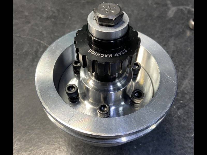

I have more of this thread to read, but I want to thank @malex for eliminating the stress I had only in my mind, should I need a vacuum pump. My "boogie man" was my CVF Wraptor serpentine belt and accessories system, and the question of how could I possibly drive a vacuum pump if I needed to. IF I can't drive it somehow with the serpentine belt, and honestly I'm not sure I'd even consider that now, it seems like I could just do something like this and problem solved.
Thanks!

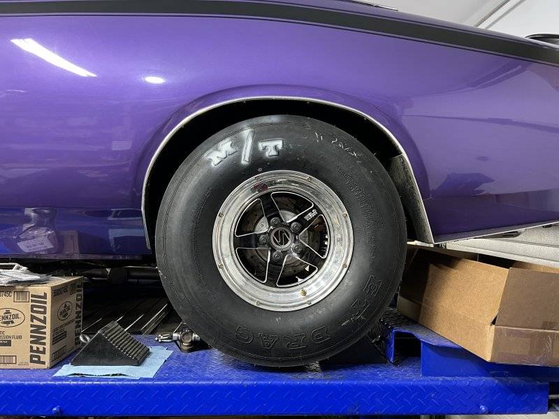

Nice! Are the fronts 28"?
I like the mud flaps too.
And the rears??
