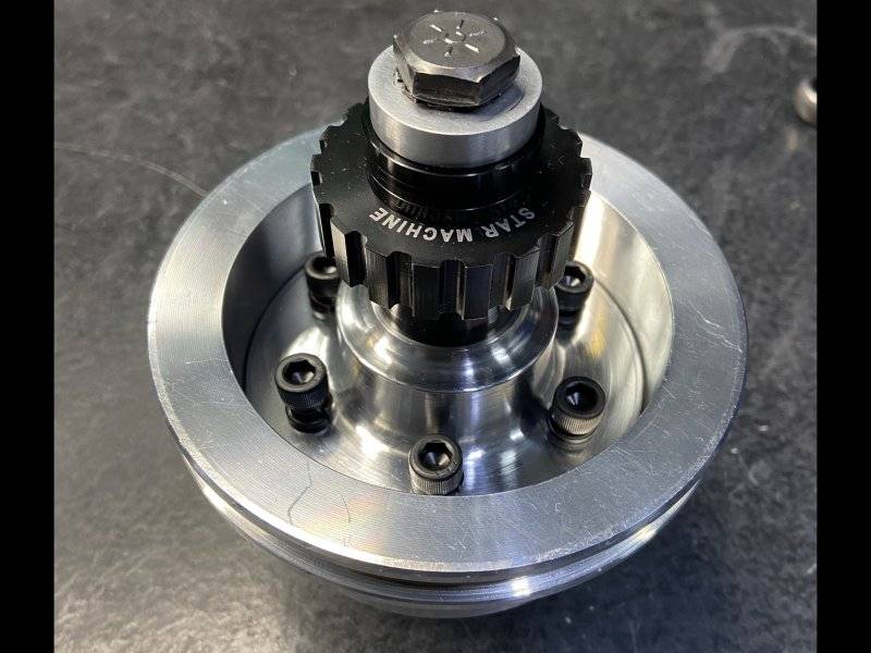

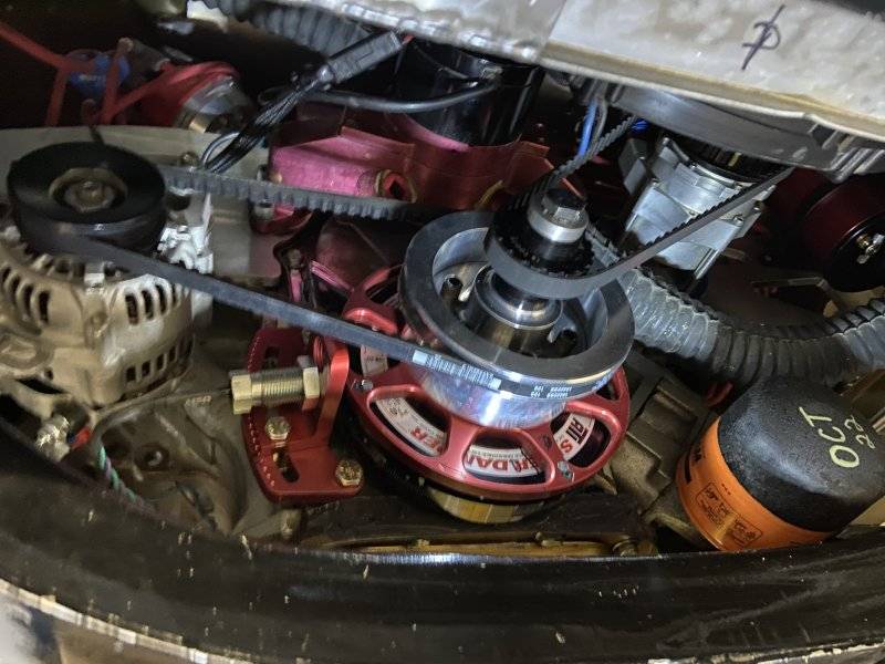

Now with that fixed up it was time to get busy at something else, I had a number of things on the list and conveniently, I located and was able to make a deal on a vacuum pump. So that was next on the list. The pump came complete, less crank mandrel and gear. Well you know how one thing always leads to the next, well a new balancer and crank trigger upgrade.

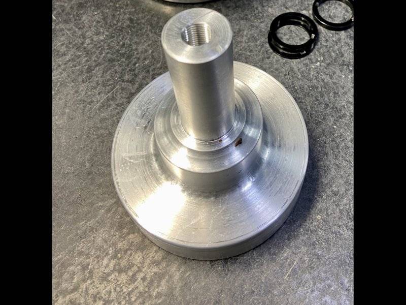

After some mandrel shopping and racer buddy (Wookie) suggestions I ended up building a mandrel. Pic partially finished.
Ready to bolt on.
Back together. Star Standard Pump. 5” vacuum running.

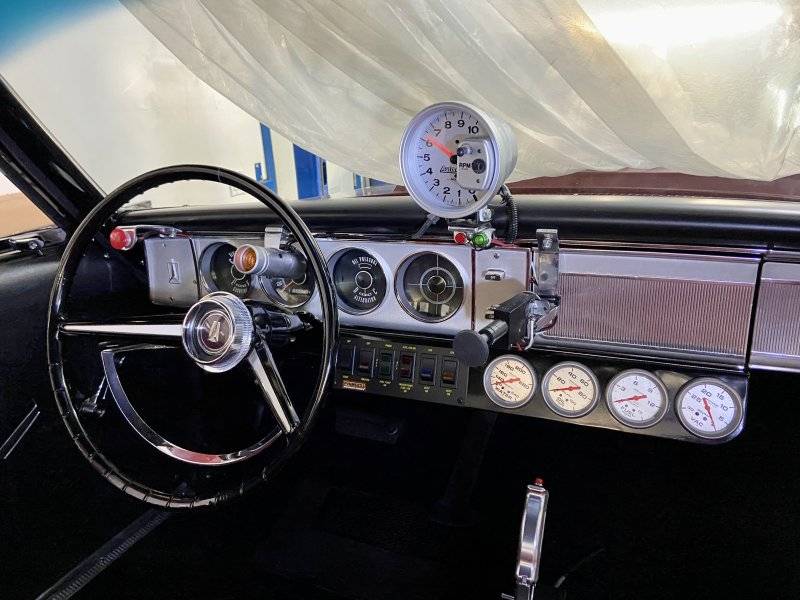

With the vacuum pump comes the need of a vacuum gauge and having to find a spot for that. This is how that ended up.
New set of Painless rocker switches and vacuum gauge in place. No more hard to reach switches and gauges all in full view. Shift light also moved over from beside the tach to dead in front of me.

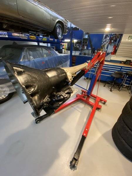

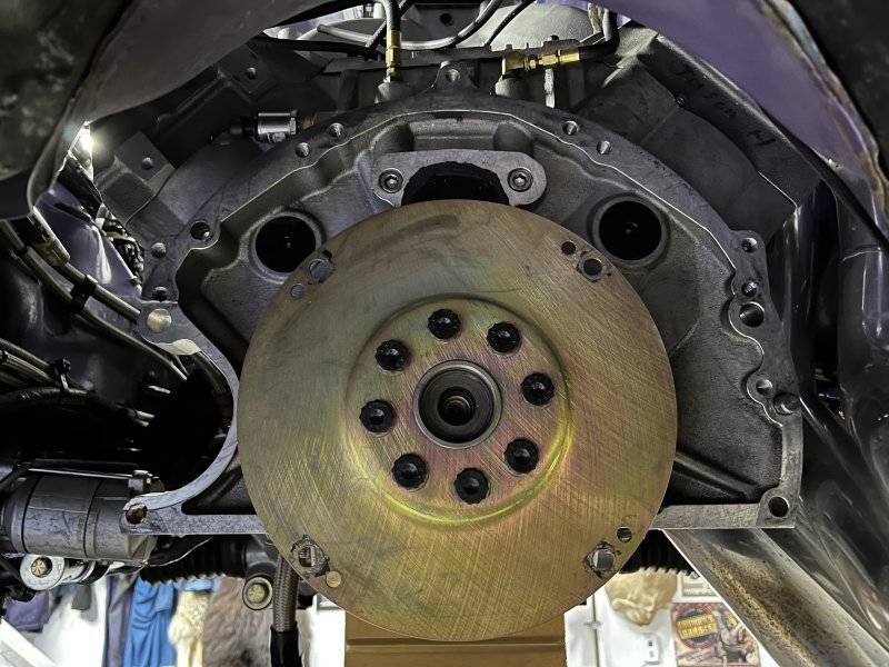

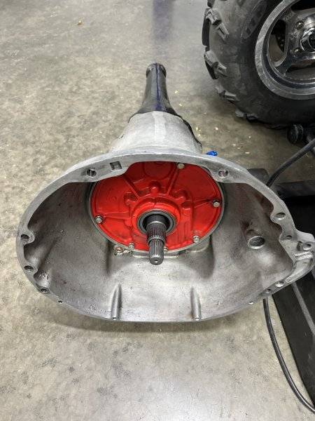

The transmission is out and in process of freshening. The converter also got sent out for freshening and a good thing that it did. Once apart it was found to have bent vanes and ready to let go. That was a surprise, it never missed a beat, but I guess that’s racing and why we do maintenance. Converter is back and ready.

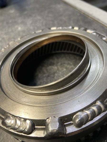

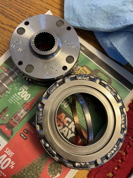

So at this point the 727 is on hold. A&A low-gear set had a loose bushing in the ring gear housing so it got shipped to A&A, who told me that they’ve never seen that before, send it, they will make it right and send it back. The bushing will fall right through, it’s been spinning.
Ready to bolt on.

Thanks, yes a nice award. I guess regardless of a 8 or 9” converter, they can all fail. Not sure why that gear set bushing came loose, although it never was tight to start with. I can only think the tolerance was a bit much to start with and it’s going to be repaired as such.

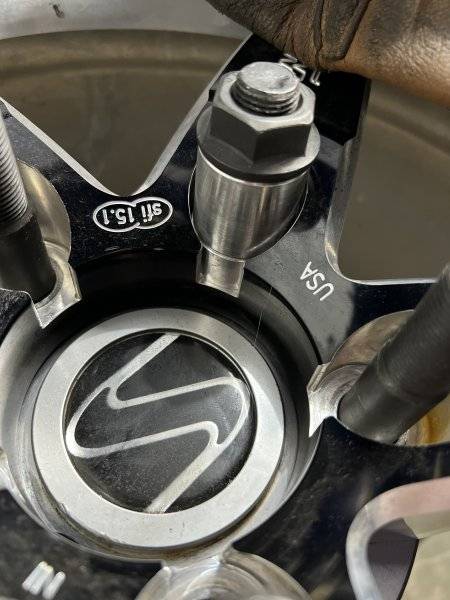

I thought my bud was going to do these studs in a couple weeks. Got a message today to pick them up after work. Are two spacers legal, or do I need to have a longer set built? A washer under the long spacer would be enough.
Did you forget your disc hat? ;)

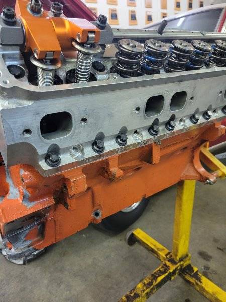

I have to get back on the mill. Kinda stalled out when I finally noticed the checker springs were at "full coil bind " @.680 lift. Will cut those down.
Then have to re vamp the pushrod checker end.
I think I have enough rocker shaft studs.

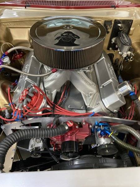

This is the old barney 440... any recollection if it was line bored?
Ahh. That was a good motor for me.
I believe it was done.
I ran a Cloyes in it as well. It was the smaller size not standard. But I believe the chain still slacked a bit.

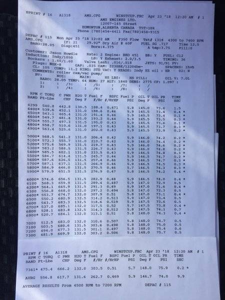

Here is the dyno sheet off that motor. It ran 10.90’s in Barney.
