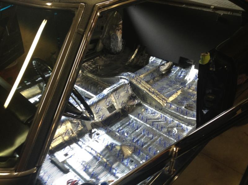

I have used Dynomat products in several builds over the years and will do so on my current Charger resto. I lined the floor from firewall to package tray, put a couple of squares on the inside door skins and did the roof. Makes a huge difference in both sound and heating/cooling. The only drawback is that once you get the car that quiet the wind noise will bug the hell out of you (o:

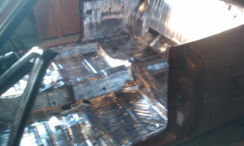

I used Rattle Trap (same folks that make Fat Mat), on my '69 Roadrunner. Did the entire floor up to the trunk, roof, inside the doors, inside of the quarters and have still some left of the 100 SQ FT I bought. Car is soon to be on the road, so I can only help out with the amount needed and not how well it works..Installation was pretty easy.
I used the Rattle Trap also, firewall to package tray, doors, quarters, kick panels but not the roof, I've had it out a few times already and it's a big improvement in sound, have to wait to see what it dose for the heat though.
