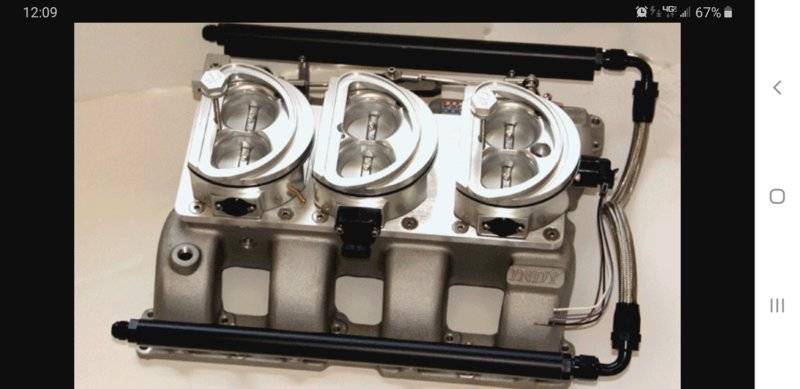

And he sent it to F&B, who makes these amazing 3x2 throttle body/direct port injection systems, usually with the Indy ModMan intake, like this:
and they may be able to use my current Edelbrock/Chrysler aluminum 6bbl intake, but for the RB stroker the A-body forum member has, they did this with the Weiand:

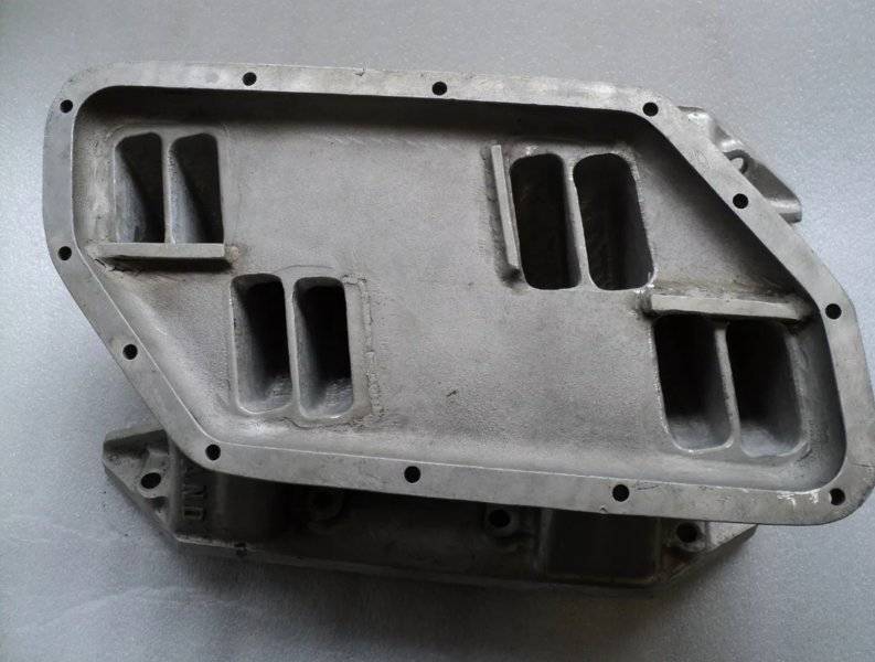

I may play with the Promax modded Holley carbs I have now, and put them on the Weiand with the recommended "dams" on the floor of the plenum, like this:

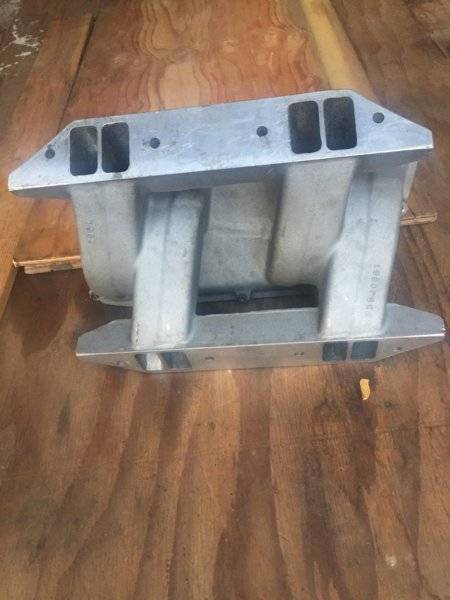

One is available for $1k and has the brace as cast:
And one for $1200 but like others I've seen, the brace has been removed, and you can see where it was:

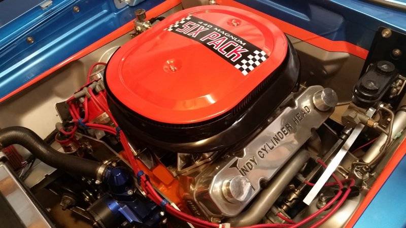

Just buy a regular Edelbrock 3x2 manifold and cover it with a 6 PACK AIR CLEANER like it did.
If you don't like the Original 6 pack air cleaner like shown in this picture on my car, then I have a billet aluminum 6 pack air cleaner like shown in the other picture in this post for sale.

Like this:
"moselyme" on the For A-Bodies Only forum has done this exact thing. The problem for me is that he still is working on his late 60s Barracuda that the RB engine this sits atop has yet to run as far as I know.
He has exchanged messages with me, and I am chomping at the bit for feedback once he gets it running.
I think that the direct port injection throttle body setup solves all of the inherent problems with this manifold, and leaves nothing but stellar performance, but I won't really know until his engine is running. He's using a Holley control system for it, and the throttle bodies are designed to flow up to 1900 CFM!

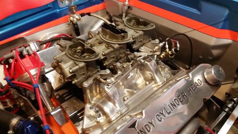

Some pix of my clearcoated, Edelbrock/Chrysler aluminum 6bbl intake. I've gotten good at taking the Holley carbs off, apart, and back together. The reusable gaskets from Promax ROCK!
