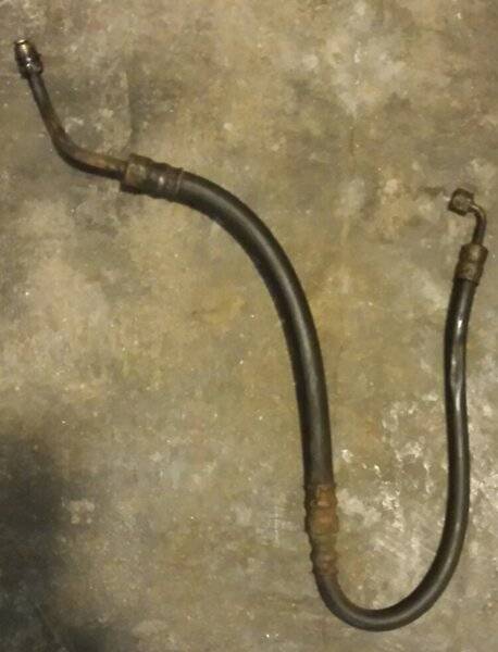

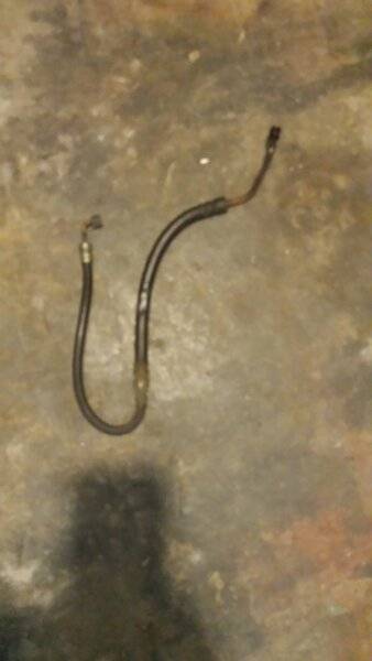

I have this driver quality factory one if you still need it
