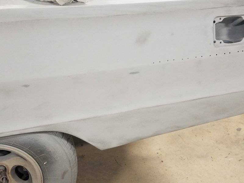

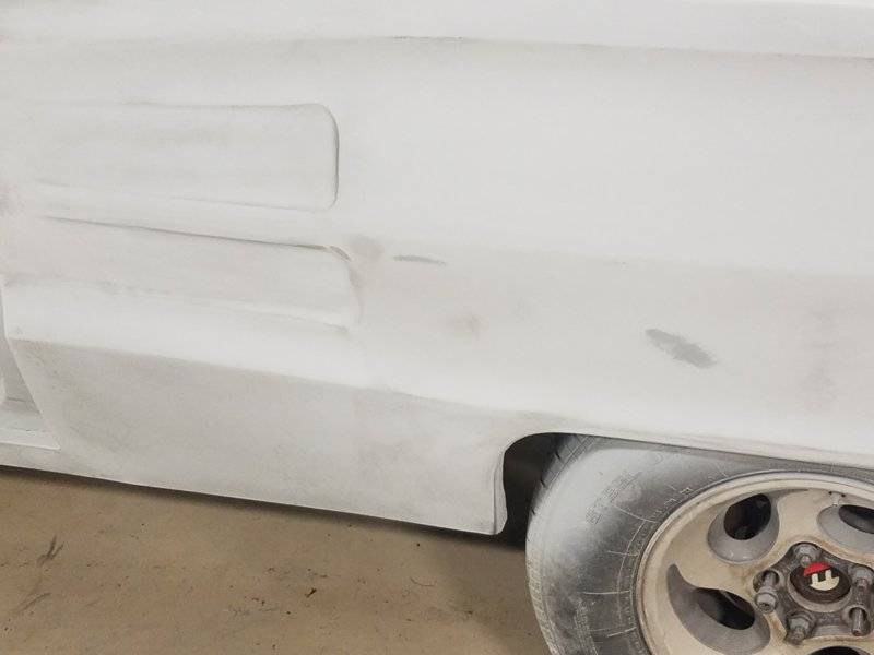

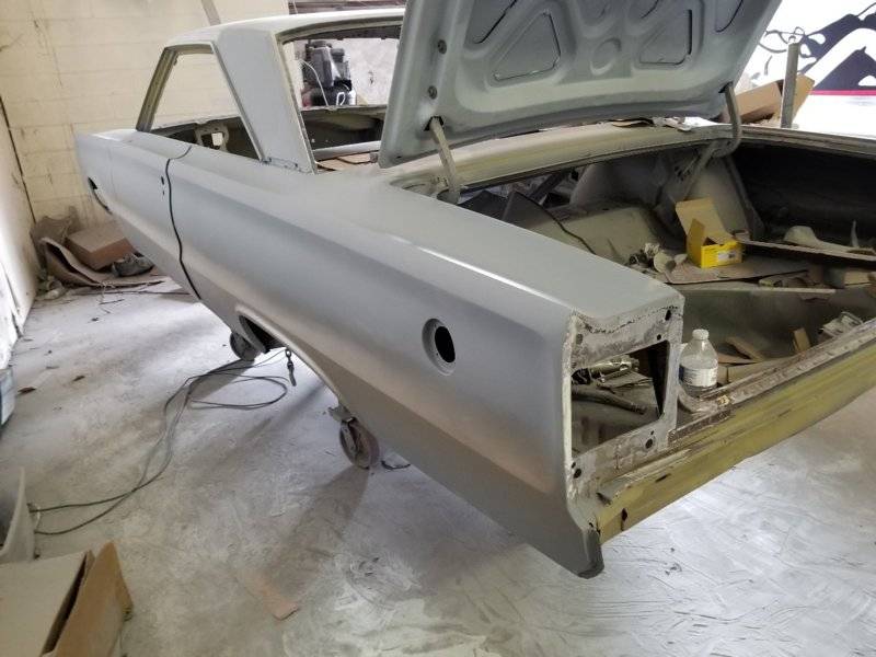

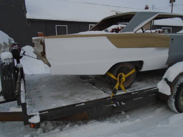

Couple of quick pics of trunk extensions and quarter panels. Panels are Larson. They worked for me but only needed six inches at the bottom. Sure a good bodyman could have made them, but thought would give a try. Equally happy with the trunk extensions. Body shop removed the bits and pieces from old panels. Everything lined up perfectly.

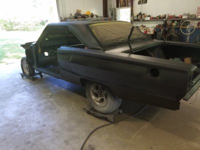

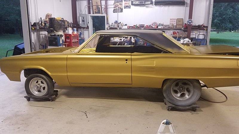

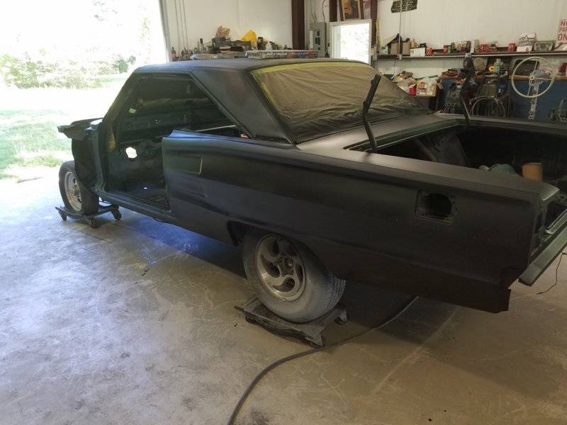

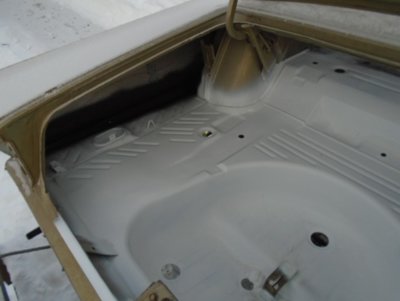

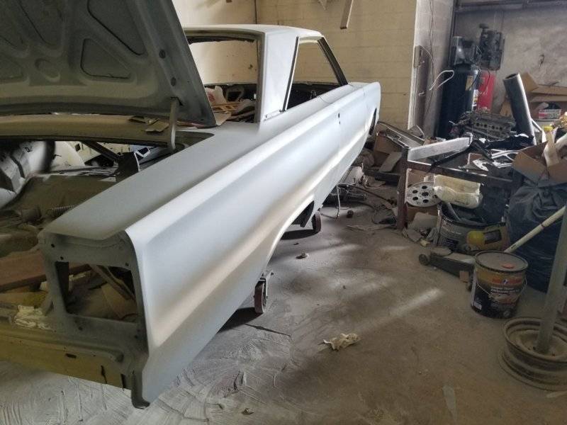

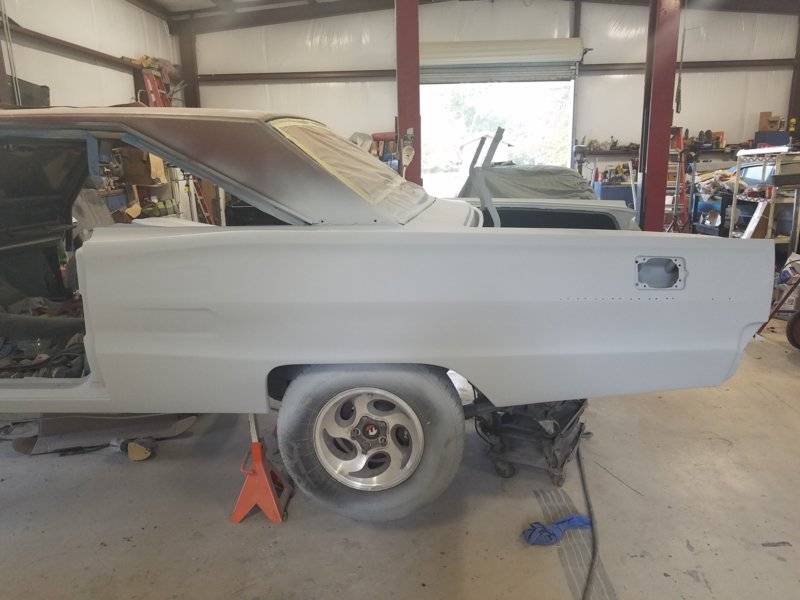

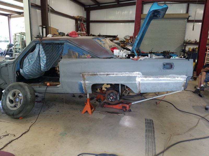

Bought both wheel well panels trunk extensions and rear lower quarter panel on my 67 from C2C and though they were not perfect fits I was able to make them work where I'm happy with it. Didn't have to pile on filler either.
20190625_200907.jpg 20190420_141021.jpg 20181215_123826.jpg 20181215_123827.jpg 20181124_152200.jpg 20180519_155611.jpg
