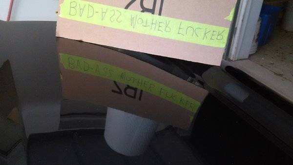

:icon_fU:
sometimes it just takes a ..........
