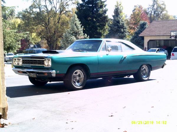

I recently painted my 68 RR the org. LL1 Surf Turquoise Metallic
"in the garage", base/clearcoat...
I did most all the body work some 10+ years ago now...
never mind the date & time stamps "they're wrong"
it was taken 10-29-2017 1st day out in the sun
or a few days before on some of the other shots
it needs a good cut & buff too, it wasn't even washed yet...
it looks better in photos than in person

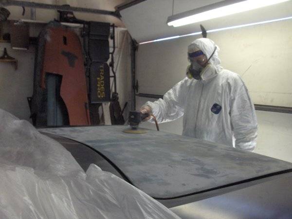

I wore a respirator, smell still gaged the **** out of me

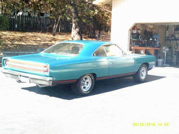

I thought the body was straight & smooth,
well it's straight, smooth part, scratches I missed didn't see etc. {?}
I thought the base {LL1 metallic} was even, 3 coats,
I thought no blotchy type stuff,
I thought the clear was decent, 3 coats shinny but a little dry
needs cutting & buffing
It looks good in photos, it ain't no show paintjob
It is a garage paintjob...
It does have color now, but I'm the 1st to admit it's a 10 footer at best
I think a lot will cut & buff out, but the **** below the paint
I didn't/couldn't see, no cutting & buffing will fix...

I thought I got all the scratches out, 220, 320, 400
I thought the lighting was a little bad,
I didn't think it was gonna' effect it as much as it did...

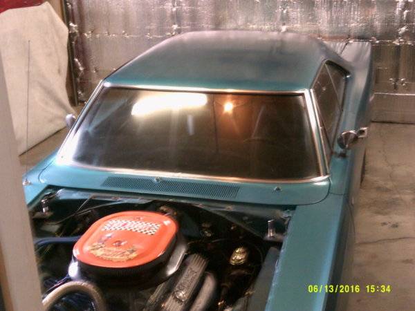

I didn't do the engine compartment either,
it's still the OE dull/worn LL1 paint
I just went down a 3/4"-1" or so under where the hood sits,
to the next break in body line, all the ledge all the way around...
And when I pull the engine again sometime in the future...
I'll probably paint the inside of the engine compartment too...
