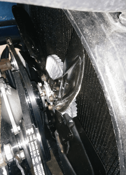

I’m having issues with my 440 with a clutch fan touching my radiator. First her are a few facts. I’m already using a Hayden 2947 clutch fan which is the shortest clutch fans available. I can’t get the factory 3 core radiator in without the clutch fan scraping the radiator. Both the tank and the fins hit. I can not install the clutch fan after the radiator is installed because you can’t get the clutch over the water pump shaft. My future plan is to buy a new Glenray radiator for the car but I’m not about to install one with this clearance issue. I have friends with a ‘64 Fury and a ‘65 Coronet that are running similar setups and their motors set 3/8” farther back than mine and all three cars of our cars are using the factory correct K-frames, transmission mounts and motor mounts. I’ve looked at everything and there’s nothing that looks out of place that could cause this.

Thanks, I’ll check with Hayden tomorrow but I’m still looking to find out why my engine sets so far forward.
Post some pictures and maybe someone can see something? Also take pics of the radiator and its mounting.

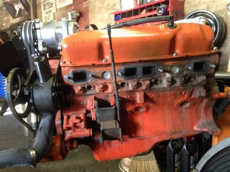

Are the engine mounts forward of the block tabs or behind the block tabs?
This picture they are behind the tabs which is the way its supposed to be.
Not real sure if its even possible to mount them in front of the tabs but I guess anything is possible.
Mopar made the tabs and moto mounts idiot proof. There’s no way to mount them incorrectly.
