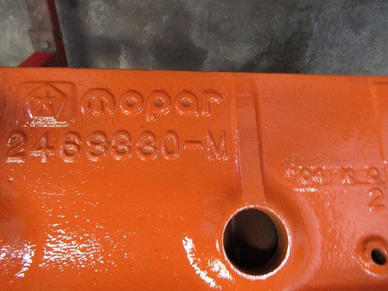

The 426 is better than the 392.Who makes water blocks for the 392 that can handle 1500 HP?:moparsmiley:
