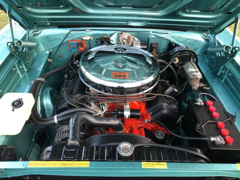

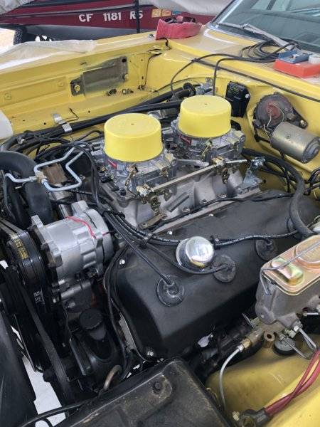

You could buy a car for the price of a Race Hemi engine. Street Hemi or race Hemi pick your poison.
Now a days they make much better flowing cylinder heads for the B and RB engines, so in street form,they can be relatively close in horsepower and torque, but in race form is where the Hemi design really shines,and with modern roller cams,they have much more drivability,and stay in tune much easier. The downside is that a Hemi engine costs about three times as much as building a wedge engine, and I know this first hand as my Hemi engine is in the machine shop right now!
