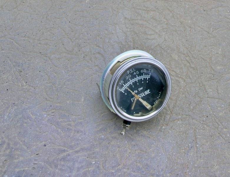

Yeah. pretty much. So, should I watch the tach needle or focus on the shift idiot light? Look at an oil pressure gauge and if it's reading zero, the damage is done. Going down the Interstate, if you look at your gauges every few minutes, YOU'RE likely to discover an overheating problem in the mirror before the gauge or idiot light.
Unless you have one of these:
...or one of these:

I’ve had oil issues before, and I’m lucky I had a gauge and watch it drop, shut it down before hitting 0. It’s as easy as looking in your rear view mirrors, which I guess you use an idiot light for that too? :lol:

2 years ago I was cruising down the freeway occasionally scanning my gauges as I always do and noticed the needle flicker, then again so I threw it in 6th and dropped the rpm's way down because looking at that gauge told me I likely sprung an oil leak.. likely saved my motor. Sure enough I get the car home and the rear main was leaking but seeing that flicker allowed me to make an adjustment that probably saved me a rebuild.
Here's another gauge story, I took a trip to Canada.. car was doing great but while sitting at the border forever with the A/C cranked I noticed that my voltage was dropping so I raise the rpm just slightly and voila it starts charging again. I suppose I could have drained the battery had I not looked but I did and now I know my alternator needs another 100rpm to adiqutly charge my battery with the A/C on.
One more story about gauges. When my car was freshly done and on her maiden voyage I noticed my water temperature rising very quickly so I pull over and give the thermostat housing a couple good whacks.. water temp immediately drops. I drive straight home and buy another thermostat.
The moral of the story is gauges are good, looking at gauges is also good, using gauges to diagnose problems before they become catastrophic is really good and saves you money...
