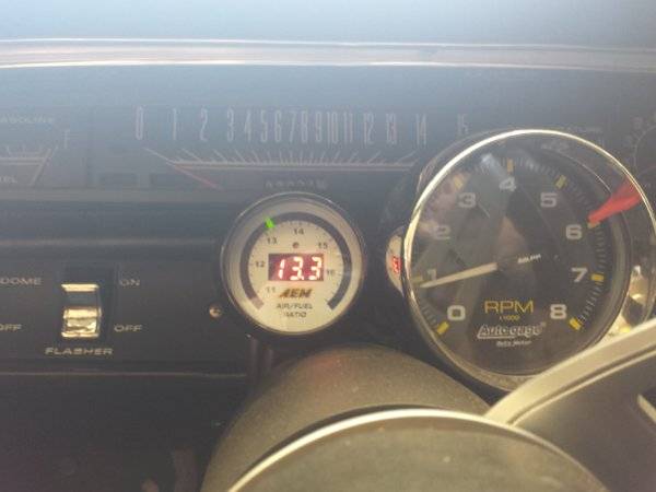

Well said! 14.7 stoic is a pipe dream. My idle is 13.3 - 13.8 to get it to idle nice. Any leaner and it feels like it will stall. I can tune it pretty close by ear and using a vac gauge and tach but the reading lets me see what it is doing real time while driving.
