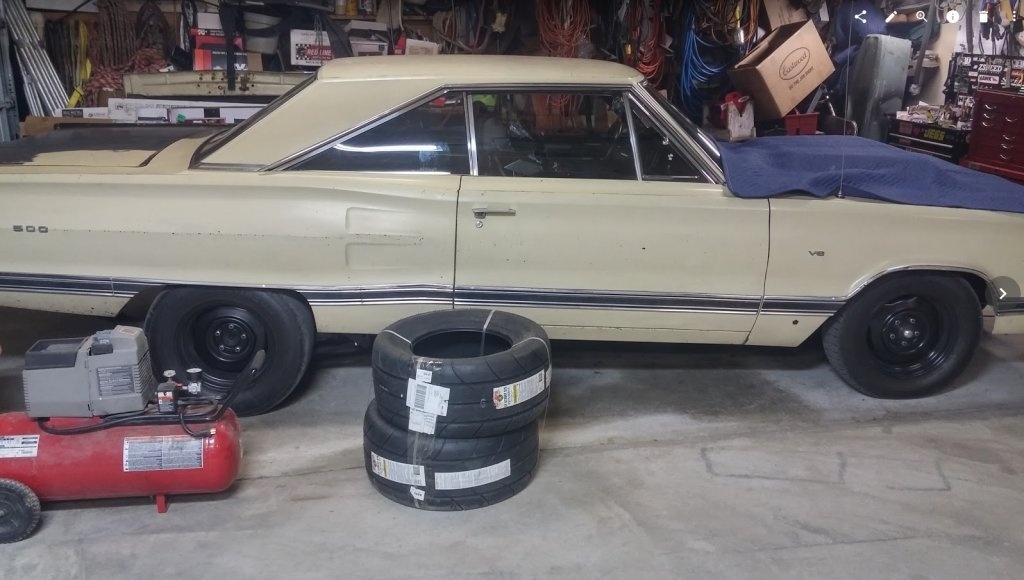

I have 255's on an 8" wide wheel with a 4.5" BS with lots of room to spare, getting ready to put 275s on.
