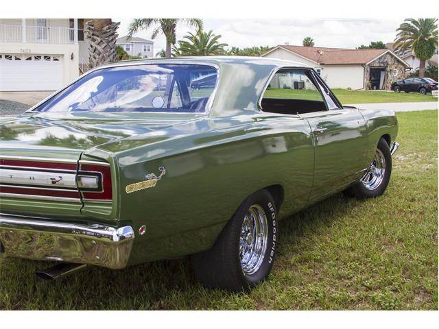

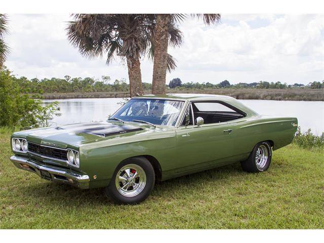

Hi there FLArunner! Great looking car, and interesting addition of the road runner bird on the rear quarter panel. :)

Nice looking '68, by the way. We would like to see more pictures of it.
