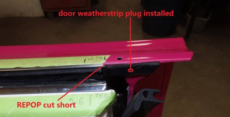

1) REPOP & PUI outside door sweeps. I think that they are both too long. they go the entire length of the door. I have the remnants of one from a coupe and it is about 1-1/2" shorter. I'm pretty sure that is because they use a weather seal plug at the end. I am not sure if convertibles use them. If they do then the repo sweeps are certainly the wrong length.

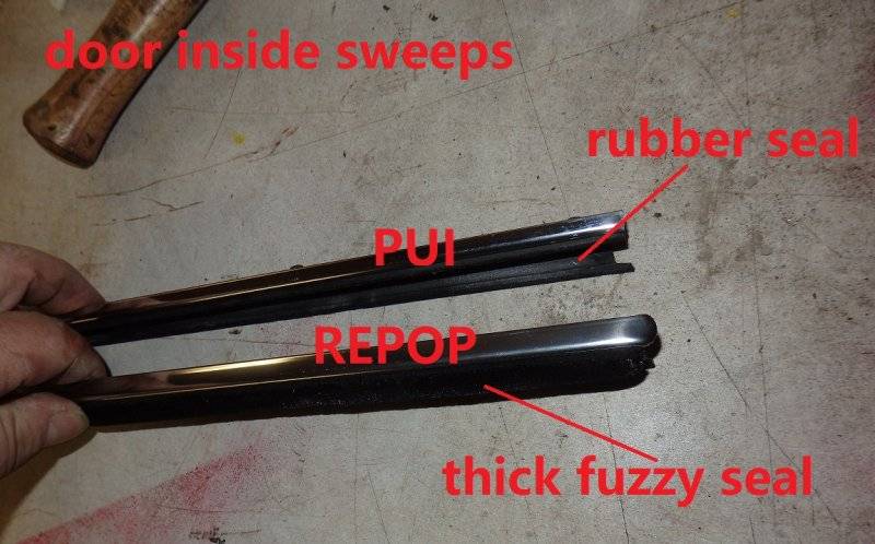

2) REPOP sweeps come with a thick fuzzy sweep on the inside. PUI come with a rubber seal just like the outside sweeps. I am thinking the REPOPs might be correct, but my new ones just pealed right apart when I tried to installed them. Friggin expensive junk!
3) REPOP inside sweeps have a much wider stainless steel flat strip bead on the side then the PUIs. I know coupes used the beaded variety like the outside. convertibles need the flat strip to cover the gap on top of the rear quarter window panels. so they carried it to the front.

It makes no sense to have rubber on the inside. On my 70RR hard top the inside is fussy. The outside on mine stops short of the end of the door and got the weather strip plug that you mentioned.
thanks for posting the pictures. Convertibles have different style sweeps on the inside, so I am hoping a convertible owner will post some pictures of what the insides are supposed to look like.

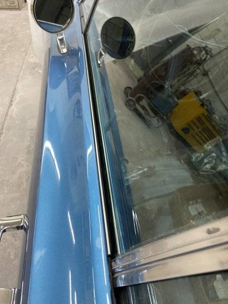

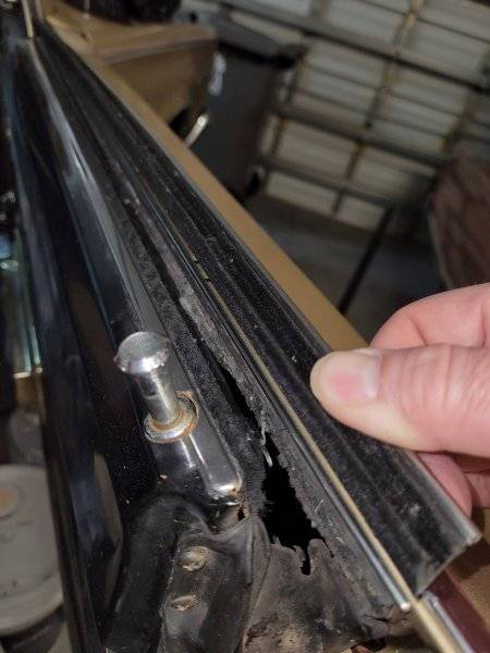

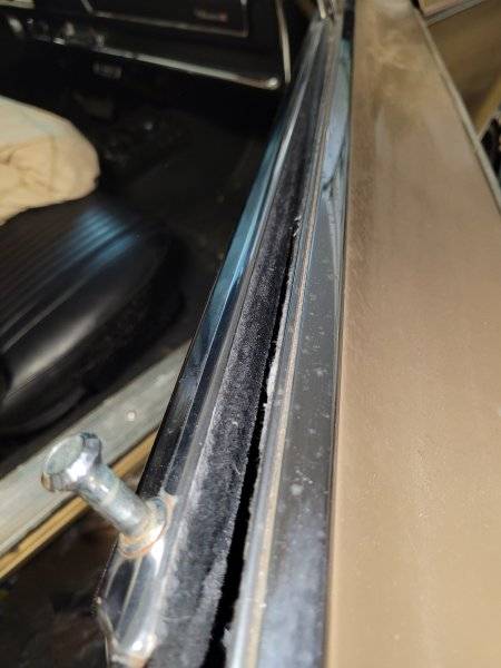

I don't know how well this applies to 70s, but I took a look at my unrestored 67 Belvedere convertible. The inner weatherstripping is fuzzy. The outer has a rubber seal with a thin fuzzy nap. The seal looks like a V between the door and window. I tried to get some pics.
660k
Pretty sure the door seals are the same between conv and hdtp since they use the same doors. I have a set of Repops on the shelf that I bought several years ago for my hardtop. I checked them against the convertible and they match.
View attachment 1387486660k
thanks for the pictures. They look like what I expect a 70 to be.

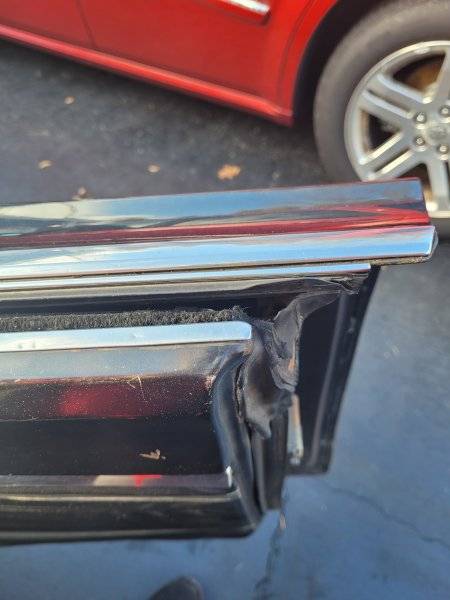

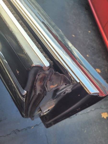

I know my outer wipe is bent, it has to be replaced.

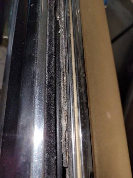

I home this helps - 1970 road runner convertible - I have never replaced these "sweeps" so this is how I bought it 40+ years ago

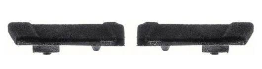

Perfect. this is exactly what I needed to see. So it looks like the REPOP kits correctly match your car. Too bad the new ones I bought peeled a part on me. Another interesting thing I learned from your pictures and chtampa is that convertibles do not use these weatherstrip end caps, but hardtops do.
