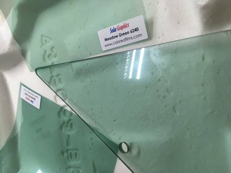

I had an issue where I needed to replace my door glass that had factory green tint. I have a friend that had the glass but it was clear, so the price was right but the color was wrong. After a lot of research I located a company called Solar Graphics and had them send out some samples that I thought would match. I narrowed it down to 2 samples "Meadow Green" and
"Spearmint", I went with the lighter shade "Meadow Green" when combined with the clear glass that has some green to it it's a near perfect match for MY 67 Plymouth.

Sweet! That is some good information if someone gets stuck in the same situation!
