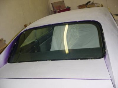

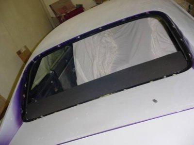

65-440 , As long as your pinch weld, around the window, is cleaned and black pinch weld primer is applied to the whole surface, your 5/16 butyl tape will stick to it like "**** to a blanket". Clean the under side of the glass & just before you apply the butyl tape to it, put a 1/2 inch wide band ,of pinch weld primmer ,all the way round & let it dry a minute or two. Make sure when lowering your glass into the opening , that`s it`s exactly where you want it, in the opening because ,Once your butyl tape touches this prepped surface, it forms an instant bond & seal.

Great info guys, thanks ! So I'm assuming when you say "butyl tape" you are referring to the 5/16 thick flat butyl not the round "butyl rope" correct ? Did you put any liquid butyl around the back glass after it was set in for an extra seal ?

The back glass use a 5/16 butyl tape same prep as the windshield.
look closely at the pinch weld to make sure it is not bent up or down it needs to be the same shape as the glass. if in doubt mask the edge of the glass and with some help set it in the opening and take a close look from inside for fit.
prime with the pinch weld primer for butyl as it is is liquified butyl from what I was told from our glass rep.
I prefer to lay the tape to the body rather than the glass. it is to easy to catch a revel clip and screw up the seal if it is on the glass. leave the paper on the tape and don't touch the seal with your fingers. use a piece of the paper between, again need a warm shop for a good seal. I have even used a heat gun around the tape before setting the glass if it is not very warm.
you then carefully push the glass down and should be able to see the glass seal to the butyl.
go slow and evenly around the glass several time until sealed.
everything needs to be real clean for a good seal. back fill the big gaps with more bedding and glazing compound as you did on the windshield.
