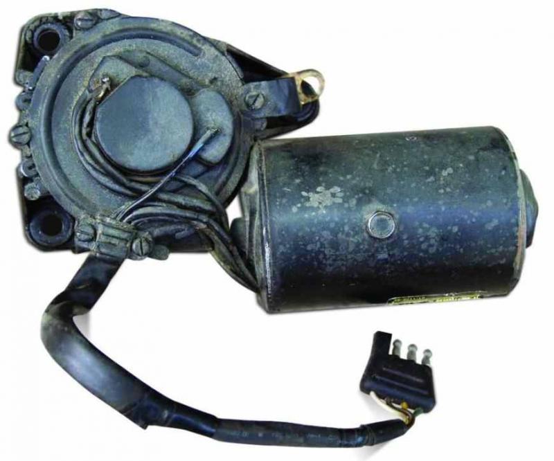

The switch that you're referring to would be the one on the wiper motor? That one works off of the motor shaft to tell the switch (mechanism) what position it is in. The motor shaft might have a cam type locator on it that makes contact with the switch. There's many different styles of mechanisms to tell the switch the location. They might strip on the shaft, break, or the switch goes bad. This switch is on the motor, not the one in the dash.
I'm rethinking this. The motor is fastened to a transmission that has this switch on it.

The big switch on top should be the park switch.
The switch is on the motor for park and it reverses the motor to park

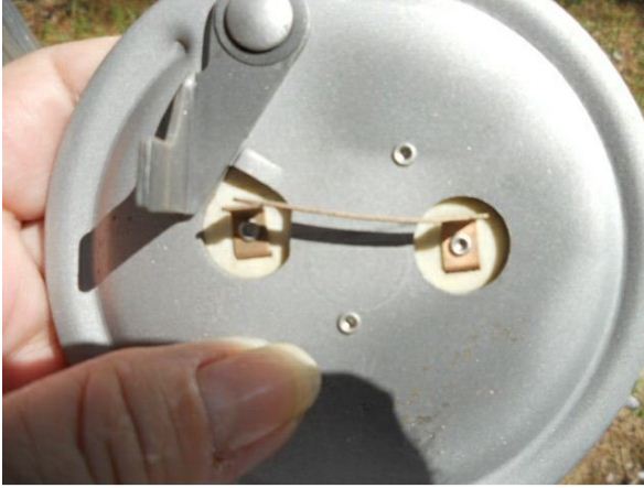

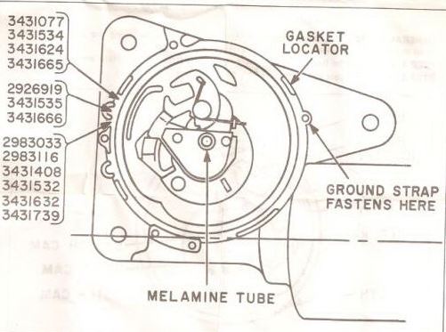

The photo of the back of the switch plate is how the contacts should look for the motor to park properly. Sometimes the gear latch will swing around and snag it and push it up or pull it down. Won't park then because the contact surface is already in a "broken contact" position. Usually you can just clean up the contact points with a file, sandpaper, etc. like you do for distributor points, put them back in their position and return the switch plate to the motor and all is well.
Clocking photo is so you know where to put the timing/clocking nib for the body style motor you have. Top group of numbers are for an E body and correct wiper arm park position for that body style, second group, C body, lower group for the B body applications. If you have an E body and put the nib in a B body position, the arms will park in a B body position.

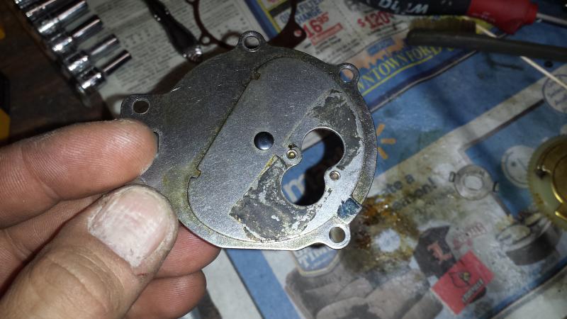

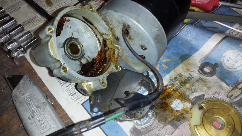

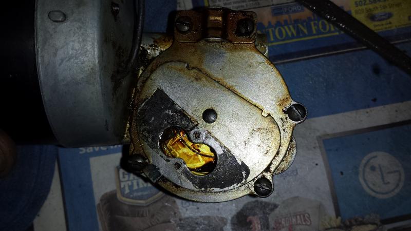

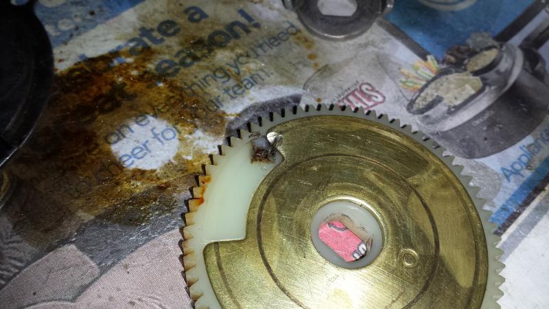

I knew I shouldn't have clicked on this thread. My park wasn't working either, so I pulled the motor to fix it. Hmmmm, that doesn't look right. Two wires going into one, check. Electrical tape covering opening where contacts are suppose to be, check. Electric HARDWIRED into motor, check. And melted gear, check. Some mechanic had his A game going on this one. And the two way connector disinegrated on removal so I have to find one of those too. Fix one thing, find another one broke!
